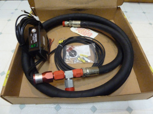

just arrived in the mail today. going to install it on the Iltis. been running 50% WVO single tank with very little mods and its getting a bit harder to start up in the mornings. this should help.

its a hose in hose? where'd you get it?

it is not a hose in hose.
this is a 10 foot 5/8 inch Racor Thermoline 24V 500watt heated fuel line.

24v... Hum, would fit nicely in my truck!
If you don't mind, where did you get it and how much? I usually prefer to use engine heat but it's nice to see what else is out there!

you can also get these in 12 volt 300watt or 500watt options. i got a deal on it or else i would not have got it. these retail for close to $1400.
I also have engine heat on my setup but only to the filter, i use this primarily as a preheat before starting the truck and for a short time until she is warmed up. a hose like this basically eliminates any need to heat the tank and quickly heats a large volume of fuel in the hose which will warm up the filter quite quickly as soon as the motor starts.
