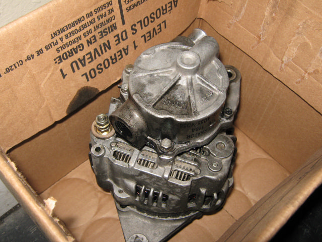

- Rising Sun Auto Import
- Posts: 1366
Re: Sizable oil leak ...
Here's an oil line at alternator.Artie Fufkin wrote:Thanks mararmeisto.
Was under there yesterday. I don't think there is a oil line to alt. It appears to go up past it & up over engine.
It looks like it might be the garden hose size line thats about 6-8 inches long from pan to oil pump? Looks like the one clamp might have slid down an not be compressing against and metal. Going to try & replace clamps if I can get my large hands in there!.
Either was it will be very messy. Need a good degreasing now.
AF
Leaking from inside?
Steven
- 4d56 alternator used.JPG (142.46 KiB) Viewed 8995 times
So is the alternator used as a secondary oil pump?
AF
AF
The oil sump on the back of the alternator is the vacuum source for the brake booster. That's it.
Artie Fufkin
- Posts: 119
- Joined: Sun Apr 03, 2011 10:48 am
- Vehicle: Pajero
- Location: Canada
jfarsang wrote:The oil sump on the back of the alternator is the vacuum source for the brake booster. That's it.
oh .... thats simple enough to understand. Couldn't figure out what that oil send was doing.
thanks jfarsang !
AF
