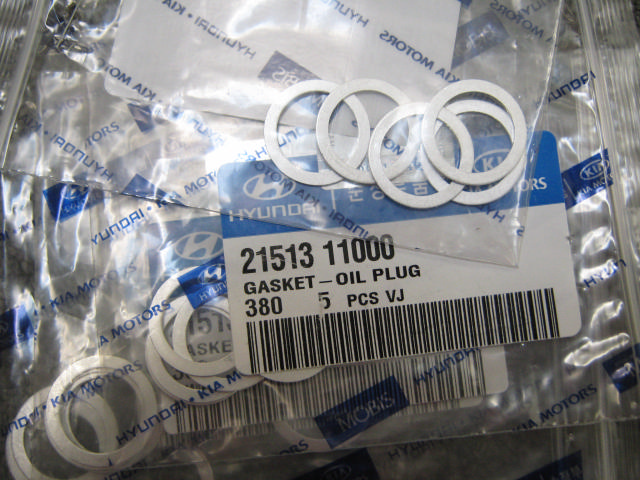

What's a crush washer? All I had was a bolt that I pulled out to drain the oil.

Something like attached pic.CREGAN wrote:What's a crush washer? All I had was a bolt that I pulled out to drain the oil.
Steven
