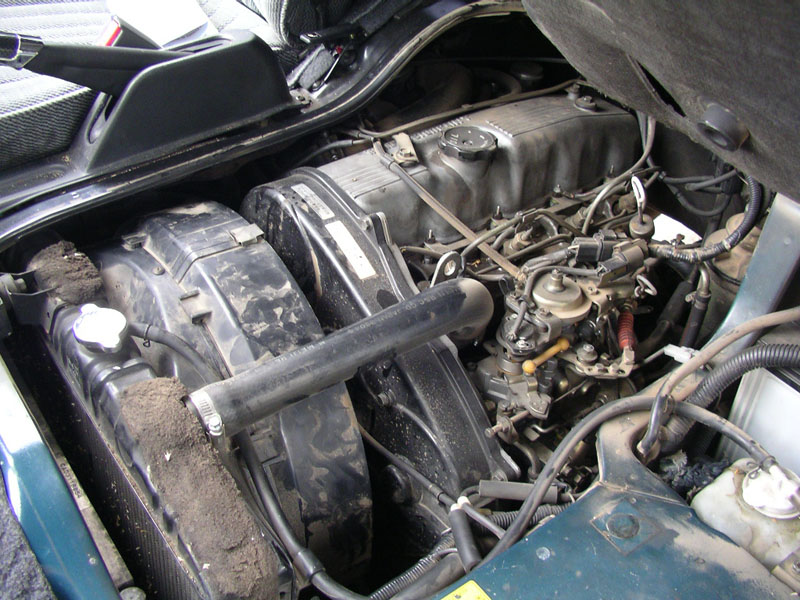

Thanks for your suggestions. Today I checked for glazed belts, and they all looked/felt pretty good. I rubbed with a bit of 120 grit, but it didn't seem to make a difference; the belts are all pretty grippy.
All the belts are good and tight, with the possible exception of the one closest to the motor, on the main shaft. It's not really loose, just a little more flex than the others.
So I applied more belt dressing, and some WD-40 on the shaft of the idler (tensioner) pulley. I thought that might be drying out over time and squealing.
I'm wondering if one of the devices driven by the pulleys is seizing up, so the belt slips on it until it gives and starts spinning. That's the pattern: about 1/5 cold starts, squeal until I hit 2nd gear. It's really embarrassing! Makes it look like I don't take care of my Deli. I imagine it will eventually do it every time, and be easier to troubleshoot. But sheesh, I hope it doesn't come to that.

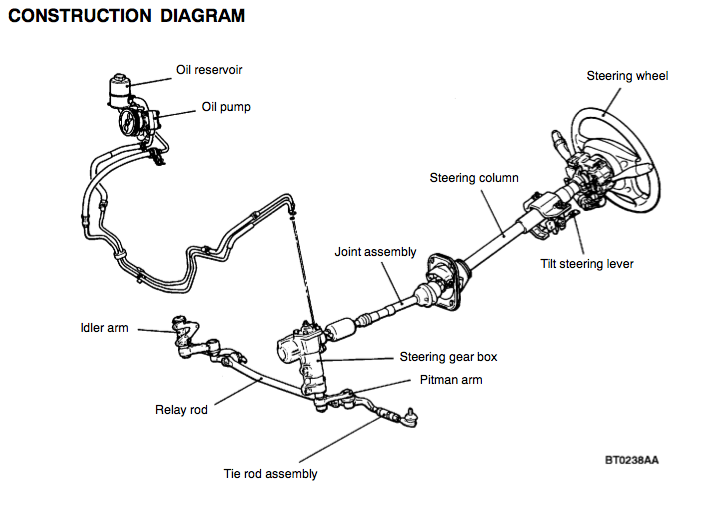

What's the most likely component to seize and then start spinning? I'm guessing A/C pump. The A/C is not functional, I assumed because it needs to be recharged. But maybe there's more wrong with the pump.
Can you tell me where to find the power steering fluid reservoir? I've looked and I've looked, and still don't see it.

I just got my deli back together last night (er, well this morning) and i believe the power steering fluid reservoir is inside the hatch under the drivers seat (the one with the wingnut, not the entire panel).

When the squeel happen again drive until it stops pull over shut it off and feel the pulleys the hotter pulley is the slipping one

Under the removable panel behind the drivers seat.Morganizer wrote: Can you tell me where to find the power steering fluid reservoir? I've looked and I've looked, and still don't see it.

Re: Squeal from Motor
Slide driver's seat forward and lift the carpet up, this hatch is beneath the carpet.yojimbo wrote:Under the removable panel behind the drivers seat.Morganizer wrote: Can you tell me where to find the power steering fluid reservoir? I've looked and I've looked, and still don't see it.

Okay, squeal was the V-belt, not the power steering pump.
