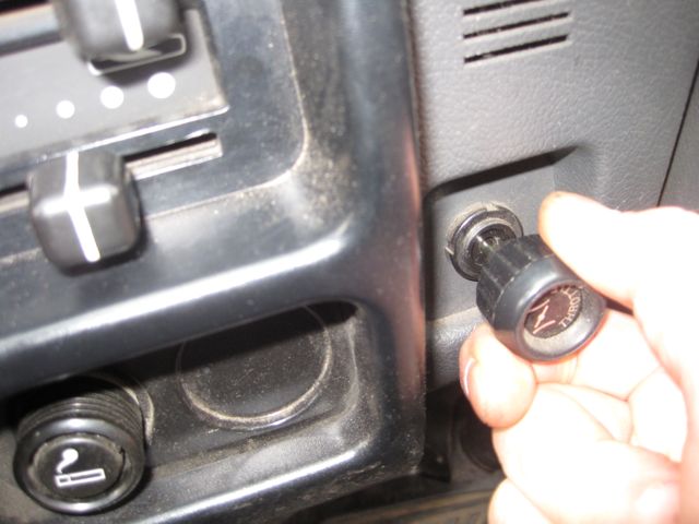

Anyone have a photo of the handle on the hand throttle.
Mine lost its knob long time ago. Still has the cable and part the knob would attach to.

Don't actually have a photo of it but it is just a slide on and fasten with a screw affair. I am going down to the garage in a bit... I could take a photo for posterity...

can you lock it off to set the RPMs up?

Here it is. Yep, pull it out and turn it to hold it on.
- hand throttle.jpg (45.58 KiB) Viewed 4291 times

awesome Thanks...need to get a knob as I cannot hold it out and turn it with me little weak fingers!

. Thanks, Kona ~ Jack, that's the one.

On a more serious note use locktite on the threads of the screw so you don't have to ask someone else to put there knob in your hand

An easy way to make the knob easier to pull, and put less strain on it: use foot on gas pedal to get RPM to what you want, THEN pull out knob and turn to lock. Much easier than pulling hard on the knob.

My knob lost the mini screw so I can't get it to stay on.
However, I got a standard-size key-chain ring, put it through the hole on the throttle lock shaft, and voila - I have an easy-to-use throttle lock once again.
