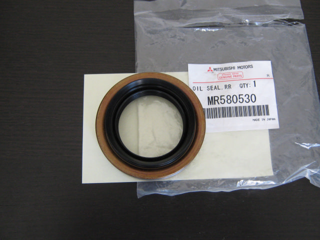

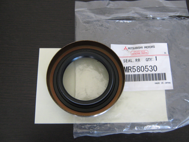

I haven't seen National 224570, so don't know if it is the same as MB160949 we were talking about.
I asked Mitsubishi Japan for MB160949, but they said it is not available any more and currently MR580530 is the right part.
Steven
Steven
