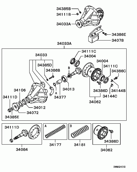

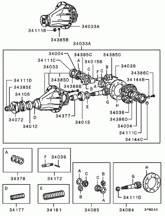

We tried to get it locally for customer repair service , but it seems nothing or hard to source.jfarsang wrote:That SKF part number is for the L300 rear diff which is smaller than the L400's. L400's have different rear diff's (larger - 2 versions)
It would be great if you can get from local part shops and show us pics.
As far as I know it has the same part number MB160949.
Check this out.
http://www.japancars.ru/cat/mitsubishi/ ... =27&bg=220
***34106***
it seems no stock now or no more making...
http://frugalmechanic.com/auto-part/skf ... ntial-seal
- L400 rear diff.gif (34.42 KiB) Viewed 7401 times
- L300 rear diff.gif (53.76 KiB) Viewed 7401 times

Part number for L300 and L400 are different?thedjjack wrote:All these trucks should share the same rear end:
Vehicles & Years
1983-1986 Dodge Power Ram 50
1987-1989 Dodge Raider
1984-1993 Dodge Ram 50
1988-1992 Mitsubishi Mighty Max
1989-2002 Mitsubishi Montero
1990-1990 Mitsubishi Van
1980-1980 Plymouth Arrow
1980-1981 Plymouth Arrow Pickup
Pls let me know.
Steven

Re: Rear diff - pinion seal - oil seal lip?
My understanding is the L400 has a bigger pinion gear then the L300. So I would expect the pinion seal to be different.
Jesse would most likely know.

- Rising Sun Auto Import
- Posts: 1366
I don't understand what you mean.jfarsang wrote:Dug up from an older postjfarsang wrote:That SKF part number is for the L300 rear diff which is smaller than the L400's. L400's have different rear diff's (larger - 2 versions)
jfarsang wrote: There are two size diffs in the L400, an 8"diff (smaller) and a 9"diff (larger).
Series 1
All V6's have 9"diff
Most LWB's turbo diesels have 9" diff
All SWB's turbo diesels have 8"diff.
Series 2
All LWB's turbo diesels have 9" diff
Some SWB's turbo diesels have 9"diff but others may have the 8" diff
There are two guaranteed ways of correctly identifying which diff you have.
First method is to measure the physical diameter of the circle drawn on the diagram, the smaller diff is 240mm and the larger is 280mm.
Smaller diff on a S1 SWB T/D is approx 240mm (Bear's diff)
Larger diff on a S1 LWB T/D is approx 280mm (Bubble's diff)
Second and perhaps the easiest method is to physically observe the termination point of the ribing on the axle assembly.
Smaller diff on a S1 SWB T/D the ribing terminates before the outer edge (Bear's diff)
Larger diff on a S1 LWB T/D the ribing terminates at the outer edge (Bubble's diff)
We are talking about 1st generation L400, no need to mention 2nd generation.
I saw part number for LWB, it is MB160949 as well.
