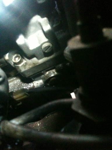

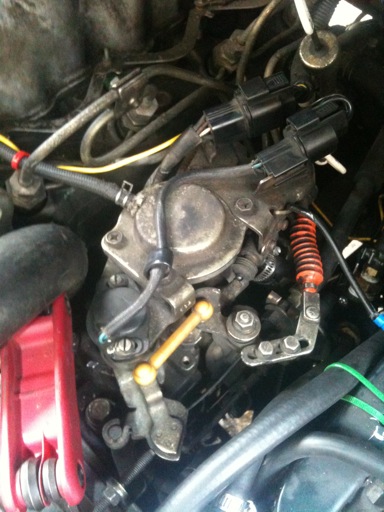

- The allen key on the left is holding the top of the pump to the bottom of the pump. This is where the gasket seems to be leaking.
- IMG_0114.JPG (48.73 KiB) Viewed 6214 times
- The leak is coming from the sides of this. The allen key (with the red handle) is in one of the screws where the top of the pump attaches to the lower part. This is the where the gasket is leaking.
- IMG_0110.JPG (73.54 KiB) Viewed 6214 times

It's a VI injector pump. You will find the manual for it in"L300 Delica Downloads". I would be inclined to find an IP shop if you can't find a trust-worthy diesel mechanic. The seals are particularly dedicated.

I recall from the open house display that there are a couple parts that are easy to re-install upside down (sort of springy pins etc) they fit just fine but then dont work properly. Be very careful opening it up, as those parts must be put back exactly (deep concentration and a clean work bench to lay out each part exactly in the direction it was removed is needed).
If it is just a gasket, and I think there are several on the ip, Veg oil often helps swell the gaskets so they leak less, but since you're already doing that then this isnt a helpful hint. There are gasket rejuvenators but they are usually just an oil also. There is a tiny o ring on the bottom about a half inch across, looks like a typical small oring, that can be replaced without opening up the ip, maybe try that one.
Did you have the IP rebuilt when you got it? If so they shouldnt have died if you're just running veg oil and diesel. Have you been adding biodiesel or alcohols or other flammable things or solvents or anti-gelling agents, which can break down gaskets. Another idea, try removing the lines to and from the IP, then turn the ignition key a few times to pump thru (yeah, messy, do it over a gravel area), sometimes a bit of crud get stuck in there, which can increase the pressure as system tries to pump crud thru and might cause too much pressure on the fittings. Same with fuel filter, crud in lines.

Thanks for all the information. I have figured out that it is probably just the gasket between the top and bottom of the pump. The van runs like a top (it has a couple hiccups when she first starts up). I also loose my fuel prime when she isn't running so i have to pump the fuel pump before fireing her up. I am far far north right now so i think that I am going to have to replace it myself.

Fixed! I took the top off and put gasket maker on the connection along with the old gasket and no more leaks. I hope it stays that way. Thanks for all the help.
