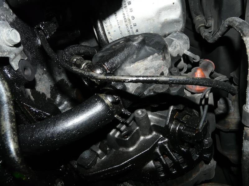

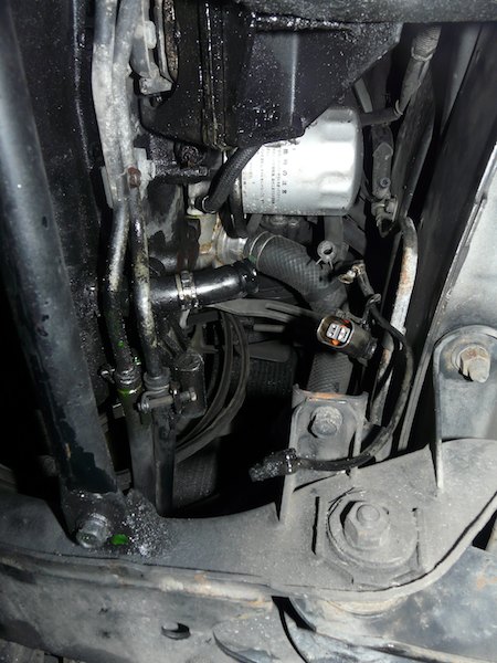

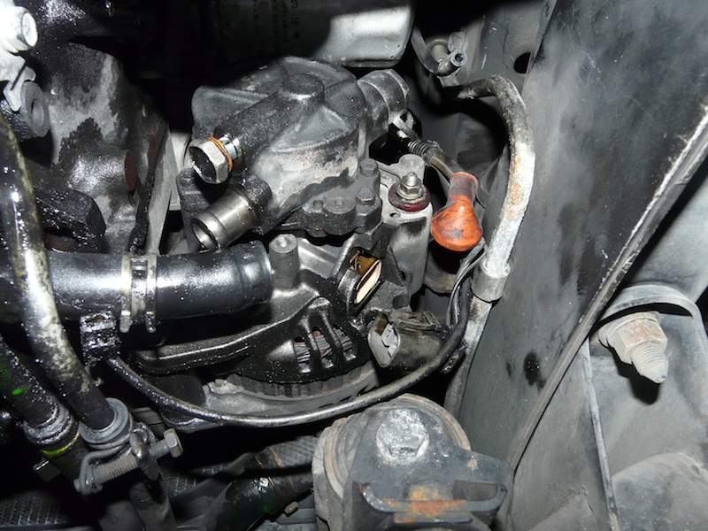

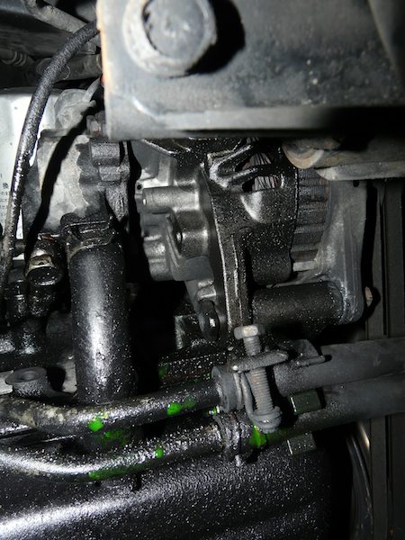

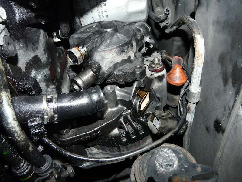

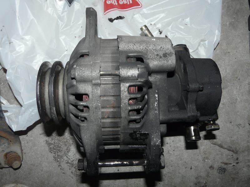

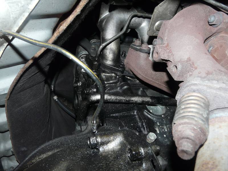

I have just come in from removing the alternator. I didn't find it as challenging as everyone was making it out to be but it was hard to follow directions with no pictures. I was going to try to take some myself to make things easier but the bot in the back was in too awkward of a position. The other thing I didn't seem to have to do is loosen the belt tensioning bolt. In fact I'm not even sure where it is. I just wiggles the Alternator back and forth until the belts were loose enough to pry off. I get the feeling this approach will make it trickier to get back on however.
The bottom of the vehicle appears to have oil everywhere and some coolant (I think from when Butch filled it up for me) Is there a preferred method for cleaning around here (especially with the alternator out) or should I just try to hose it down?
These are the best pictures I was able to take and as I am not too well educated when it comes to mechanics I won't attempt to label anything... :-D

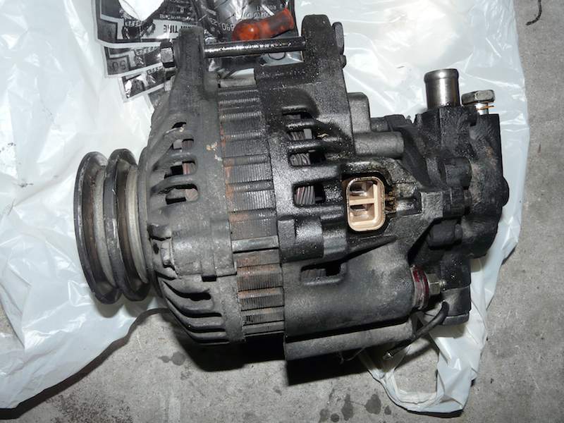

and the other side :?
alternator 1.1.jpg (73.57 KiB) Viewed 4893 times

Taking the Alternator to Brighouse to get it rebuilt tomorrow hopefully and install will be done on Friday if it is ready by then. A big thank you to Tardisdeli for all the help diagnosing the problem. Hopefully this solves all of my problems.

nxski wrote:The bottom of the vehicle appears to have oil everywhere and some coolant
Hmm... just to be safe, with all that oil & coolant there (oil could be just from filter changes) it would be worth taking the 1/2hr to look closely to where the fluids might have originated and if it's anywhere near the bottom of the timing/balance belt cover then pop it off a little so you can peek inside to see if there's any oil & coolant in there around or on the belts. If there is then you prob. have a leak - oil seal(s) and/or water pump - and you'll need to get that fixed asap before you break a belt. Oil degrades the belt strength quickly (not sure about coolant) and a broken belt usually = big problem$.
Good point.
Must to check it out. :M
Steven
Re: Help, not starting! - Alternator
go underneath with a flashlight and look up (on the turbo side - driver's side) at the top of the engine where the valve cover sits on the head at the rear. You'll see a toonie sized half-moon seal. These are notorious for leaking there, even with a recently replaced one. The oil makes it's way everywhere but usually down alongside the block and saturates the alternator like in your pics. All because of a little seal up top. Very common.
Solution - new half moon seal with sealant :M
The coolant drops on your oil sump pipes are probably from the heater hose above the alternator. Those stock clamps are horrible and when used opened/closed a few times will stretch and you'll have a bit of coolant seeping out of that heater hose. Very common as well.
Solution - clean hose inside and make sure it's not deteriorating / new clamp :M
Check the rad hose clamps while you're at it. Looks like the stock one's.
