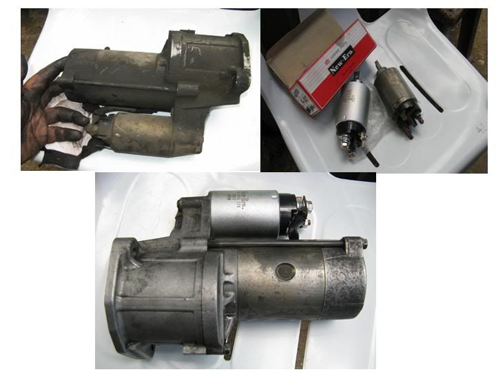

Hi,
I got same problem, same symptoms_ but in my case it was the starter solenoid.
cheers,
ka43
