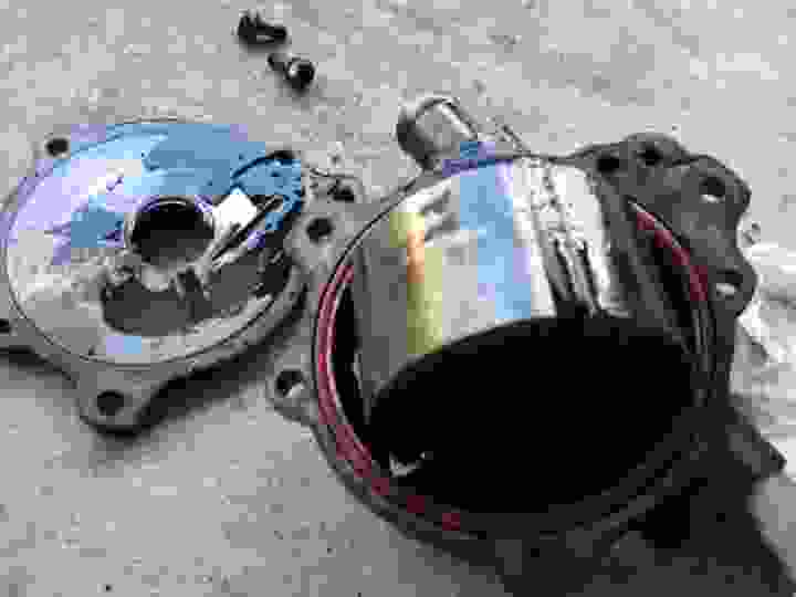

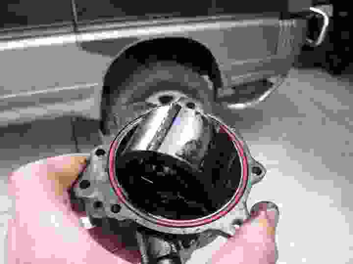

Hey guys my L300 Turbo oil pump is pooched. I phoned around and people were surprised mine failed. The shops all said they would get back to me but no one has one on the spot. (lower mainland) But it is sunny today...
Was down in westport when my Deli started growling at me. Thought it was the alternator bearing but pulled it out and it spun fine (pain in the butt, but thanks forums for helpful tips). took the oil pump out and apart, sure enough metal chips inside. :( The filter in the banjo looks okay, hopefully the turbo is spared.
The surf was good so I still count the weekend for a win (plus two more for the canucks)
I think I will get the alternator rebuilt because I don't want to be in there again anytime soon.
If anyone has one I can pick it up today
Some pics, because everyone likes pics.

Dundee Electrical in Langley was able to get a new Alternator (made in Canada) WITH the oil pump and all Banjo fittings for $385, got it this morning and had it all installed and finished before rain started :) Pokey's back in action and supported local businesses.
