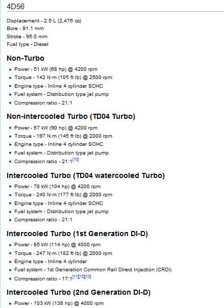

Re: L300 Stretch updates
WIKI indicates up to 138 HP with direct injection. I'd like to see someone try this.
- 4D56.jpg (35.3 KiB) Viewed 7597 times
