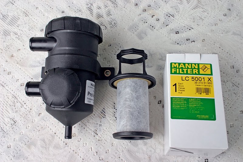

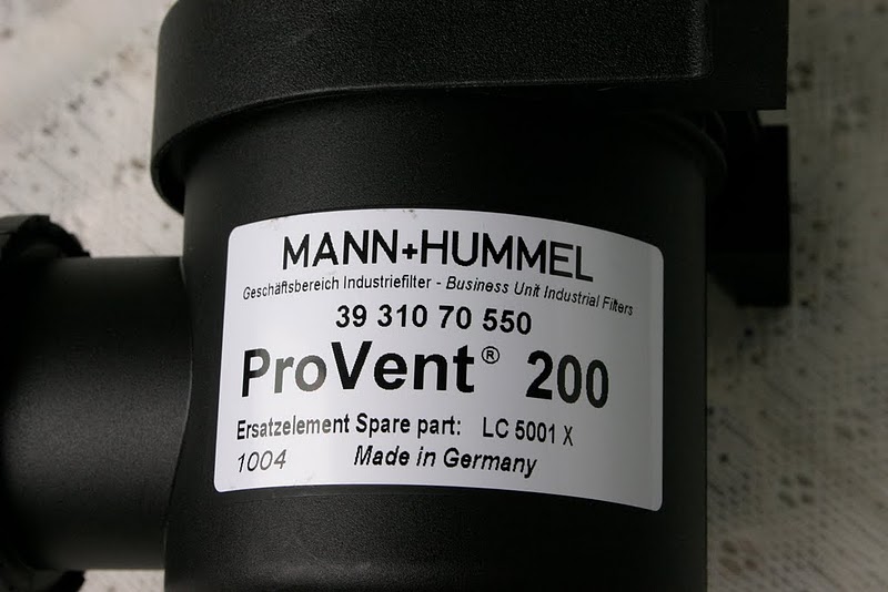

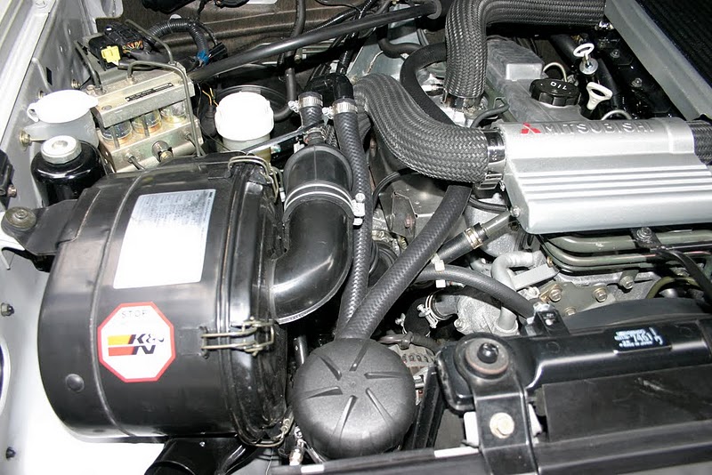

I think this topic did not have enough coverage, so I dare to post this. The friend of mine installed a German made Provent oil catch can on his Pajero to keep an intake manifold, an intercooler and a turbo clean. I got one to install it on my L400 when it arrives. Here are some pictures to give you an idea what I am talking about.

- This is how it looks installed on Pajero.

That Mann catch can is the best looking design I have seen (ie compared to the useless Greddy etc units with no baffles etc...but are CHROME lol). Where did you order it from? Do you know what the inlet/outlet inner diameters are?

But seriously, I actually ordered a Chrome Ebay unit. Why? Well, I was originally considering building one out of an air hose filter from Home Depot for cheap, then I figured I would just order one that does the job and is already made. I think that going for all the extra stuff like baffles and filters is a bit of overkill given that the Delica does not even come with a can in the first place!
And, given that it was $3.00 extra to get a chrome vs. non-chrome, I went all out on the $$bling$$.

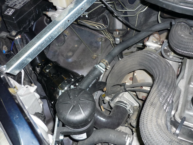

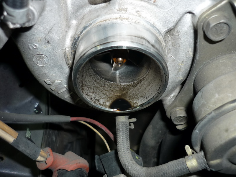

Finally I put my hands on my new ride and the Provent oil catch can is in along with some other goodies. The first picture illustrates the reason for this modification and the second one shows how a Provent looks installed:
