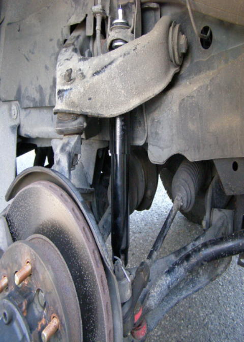

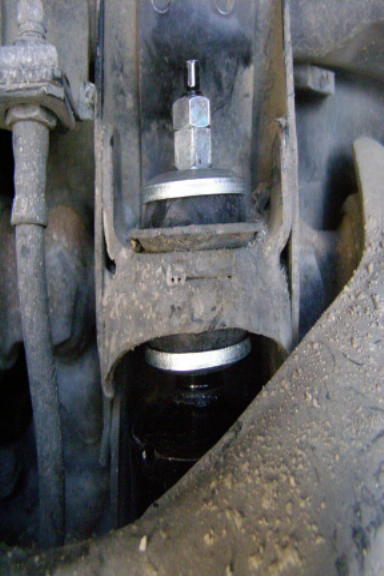

Changed out my front Shocks today,And what a Difference!!When I pulled out the old ones they were original and Totally shot!!
Here are some pics to help anyone who is thinking of doing this.
1)Jack up and remove Tires.
2)Remove Two Lower Bolts with 12MM Wrench.
3)Remove Top 14MM Lock Nut and Retaining Nut.
4)Pull Shock out.
5)Put new shock in with new Isolator Rubber and Hardware.
Cheers!
4)Pull Shock out.
Cheers!

Re: Wow thats Easy.
just changed my front shock the other day.
the 2 originals i removed could be compressed by hand and would not return to extended length without me doing so. major change in body roll and braking characteristics.

Re: Wow thats Easy.
Yeah me too!!I could push the piston in and it would not return on both sides.Now it does not feel like when I go over a large speed bump my bushbar will scrape the pavement.
