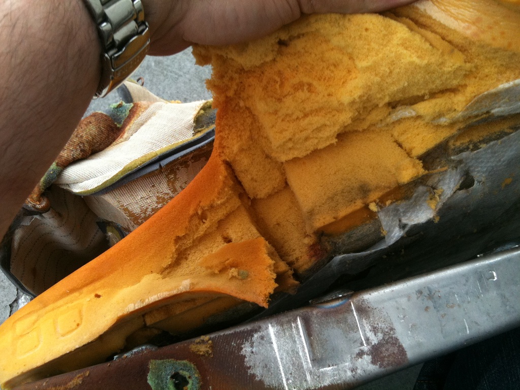

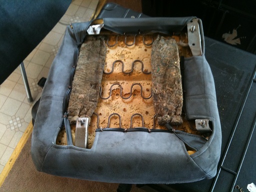

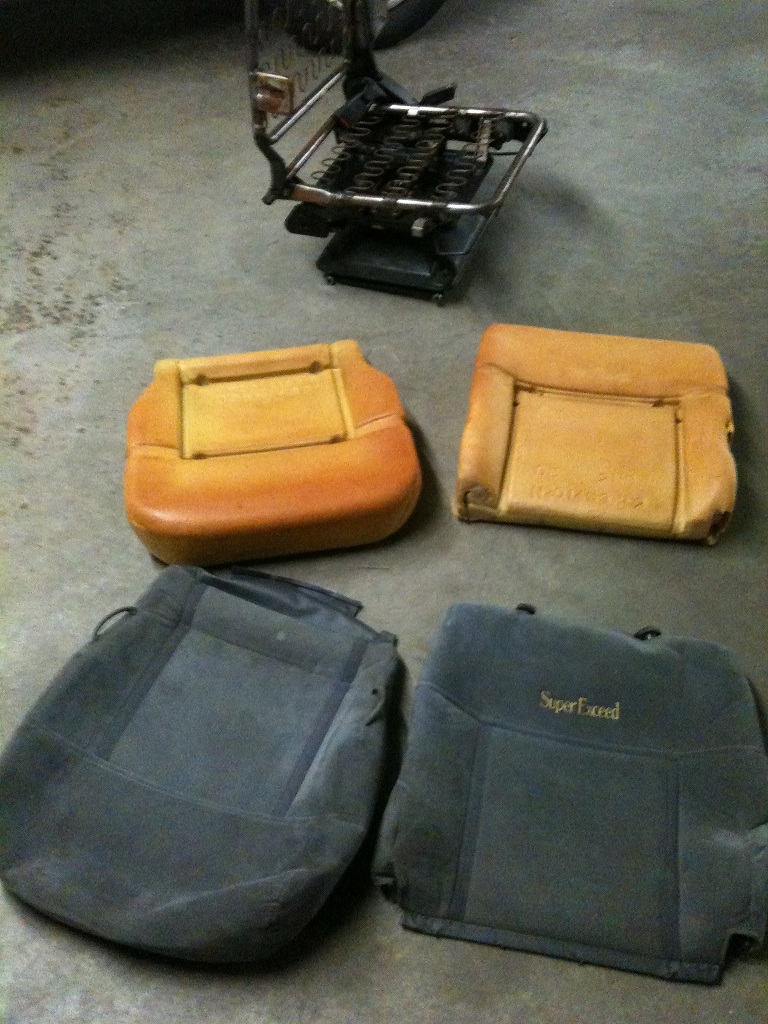

Well, I pulled apart one of the captain's chairs today and had a look-see at the guts. The foam is in great condition and the covers are also in good repair. And the moment of truth: both match up nicely to the front seats. So I moved on the busted driver's seat. This is where I discovered that someone had disassembled it and neglected to put it back together right. The back was not connected to the base on one side!
After removing the cover from the base I could see that the foam was completely collapsed on the right side, where the driver "dismounts" from the Delica. There was also a split in one of the seams, which I'll sew up before I reassemble. Considering a run through the delicate cycle and hang dry for the covers...
Going to re-use the foam from the captain's chair for the driver's seat. Quick fix for now until I can get cracking on new foam top and bottom, and sew up some custom seat covers (the microfibre does not age as well as real car upholstery).

The foam went on cleanly; only had a to make a slice to fit a support on the left side of the seat. The back of the captains chairs is a bit longer but the foam compressed easily and actually fit a bit better than before.
The original cover went back on, although it is thrashed inside and out, and I'm committed to making new ones. I had to sew on replacement muslin to anchor the front of the seat panel, and didn't even bother with the back (hence some wrinkles; its temporary.)
The seat is much more supportive and evenly balanced now (there is actually some foam left on the right side!) - yay! I'm not sitting crooked.
I agree with Felix that the stock foam is too soft and squishy (even with the much firmer captain's chair foam). I will definitely upgrade that too.

Probably got something to do with 20 years worth of use/deterioration. Even if it's not been used as frequently as the front seats, the foam is still breaking down over time. It becomes dry and crumbly.RichD wrote:I agree with Felix that the stock foam is too soft and squishy...
