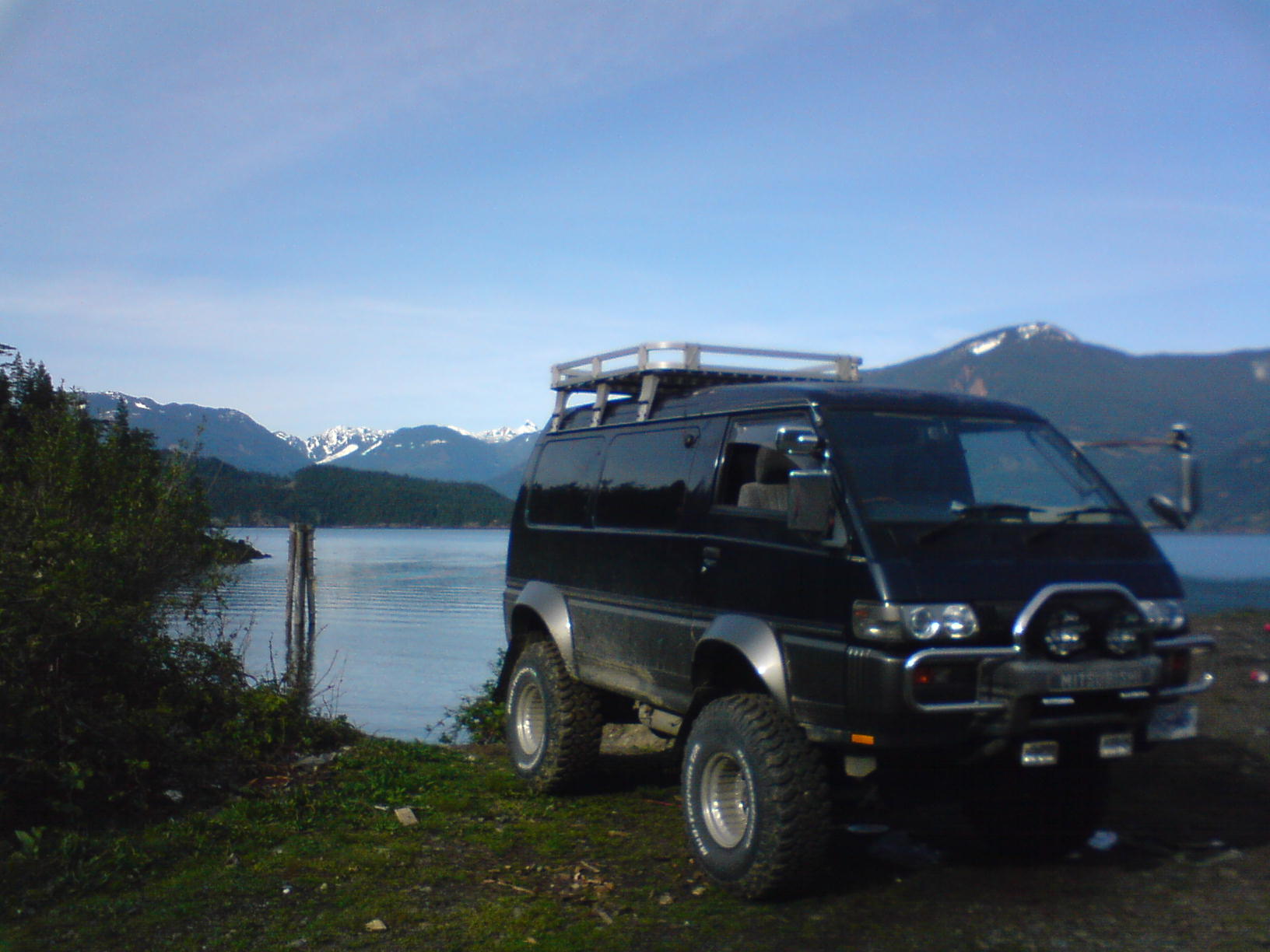

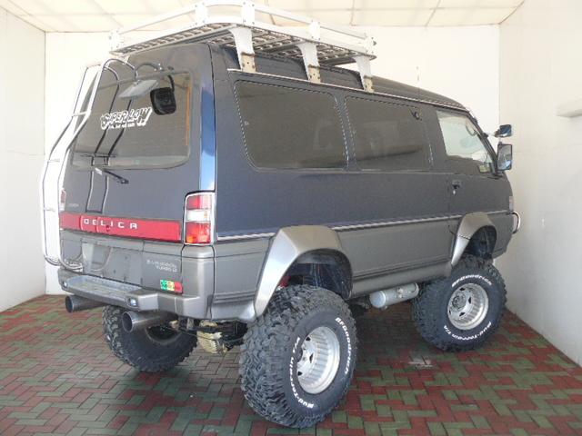

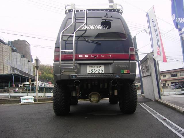

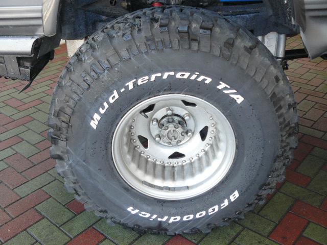

Since people have been asking for some pictures. heres some
- GetAttachment[1]w.jpg (56.37 KiB) Viewed 5686 times
- GetAttachment[3]t.jpg (43.47 KiB) Viewed 5685 times
- GetAttachment[5]1.jpg (43.3 KiB) Viewed 5685 times
- 2010_0519Image0070.JPG (182.23 KiB) Viewed 5683 times

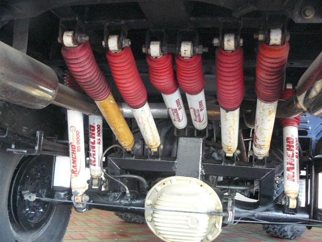

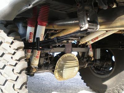

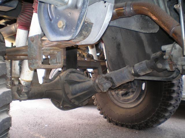

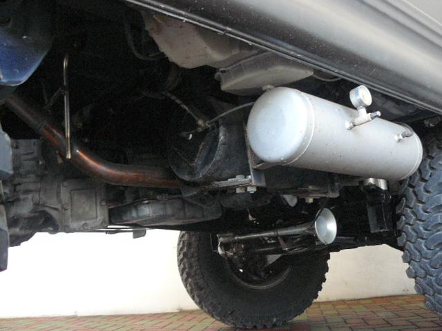

some more pics
- GetAttachment[2]e.jpg (51.46 KiB) Viewed 5675 times
- GetAttachmtent[3].jpg (39.92 KiB) Viewed 5676 times
- GetAttachmendrt[1].jpg (28.04 KiB) Viewed 5674 times
- GetAttachmengat[3].jpg (53.51 KiB) Viewed 5674 times
Re: 1995 L300
Awesome shots of the rear suspension, but what about the front?
Is the pressure tank for the horns or air lockers?

Glad to see some Canadian mud on it Robert, looking good!

Looks great Robert
Keep an eye on 2 things. Rear driveshaft u-joint at the yoke (tcase side). The angle is pretty extreme. Unfortunately there's no permanent solution to the excessive wear due to the angle. Just keep a spare ujoint and hammer/tool when you're in the bush. Trust me on this one. Comes from experience blowing one, not learning, blowing a second and then learning.
From running 33's offroad, I had problems shearing the front right shaft at the splines twice and found out that it's common. The solution is to ugrade to the larger diameter 28 splined shafts that come on the V6 montero's and Pajero's.
Just mentioning this if anyone is or will be running 33-35"+ tires on these rigs.
Some stuff is good to know for preventative measures.
