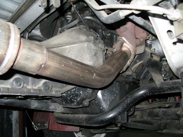

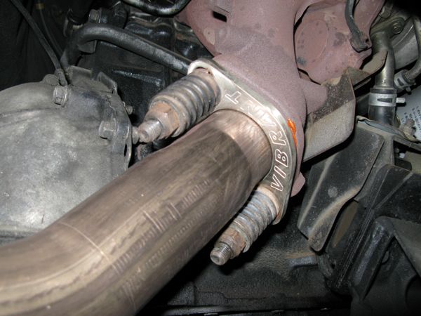

Re: Another exhaust question: flange size/downpipe/DIY?
That's how a properly done flange should look like if you find a shop who is willing to do it right (and not charge a fortune).
The man is correct.fexlboi wrote:That's how a properly done flange should look like if you find a shop who is willing to do it right (and not charge a fortune).
