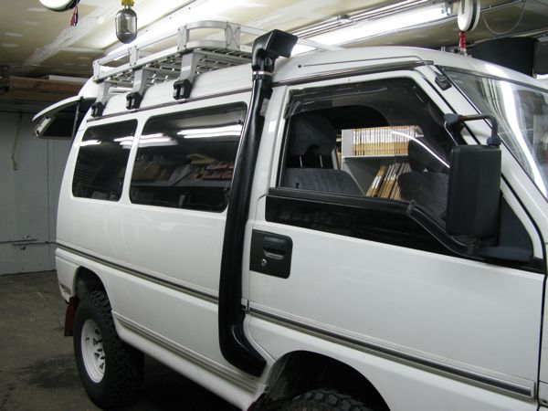

Re: Snorkel for Delica L300 - group buy?
Unfortunately not, but they are easy to paint.
Hey.... Black looks sharp on white, especially if you already have black trim on your white mule. That's my take on it, anyway.

The snorkel project is almost done. Thanks to Delicat's cute Chinese welding girl, the air canister has now a straight 3" SS pipe, which goes right into a 3" fitting (HomeDepot drain pipe) on the snorkel. The little outlet on the original snorkel was just to small for our taste. Also thanks to Jay's chemical toys we filled up the bottom part of the snorkel with expansion-goop-stuff to not waste any airflow. The air canister is also now equipped with a K&N filter. It's a really nice low profile snorkel, but not 100% accurate to the shape of the body panel.
After the first test run (and even with the still missing rubber hose connection) I can say WHAT A DIFFERENCE in power! The engine gets just much more cold air. The downside (at least for now till I modified it as well) is that the pressure relief valve goes all the time. Beside Garyo (http://www.delica.ca/forum/how-to-raise ... -7159.html) has anybody else experienced this?
Read more about my install at: http://dinoevo.de/2010/04/snorkel/
