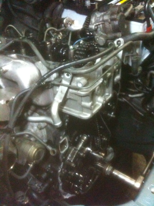

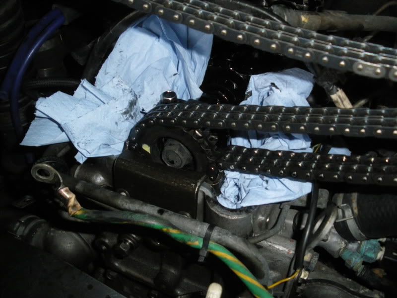

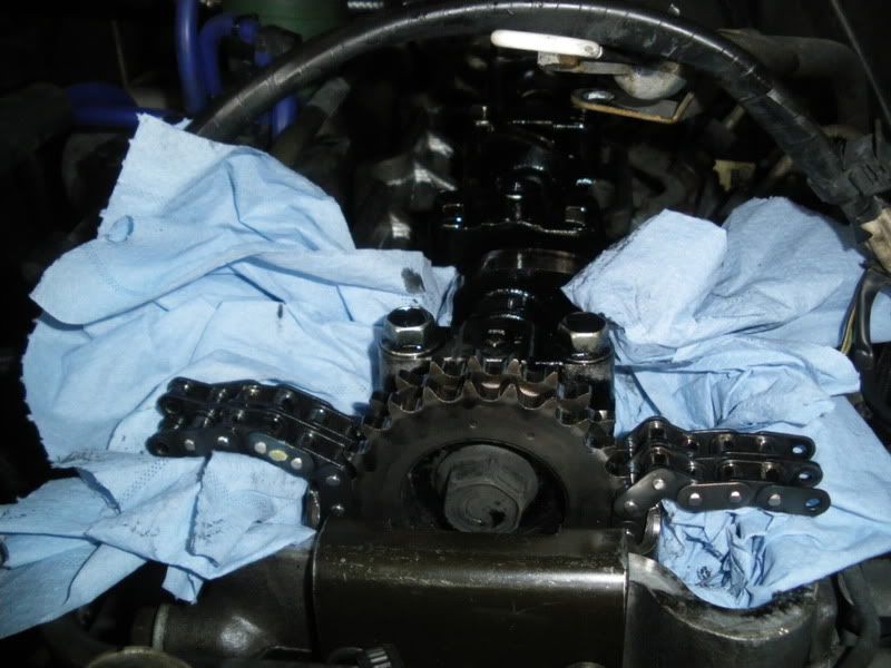

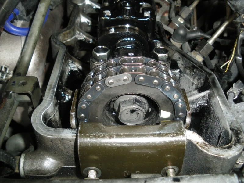

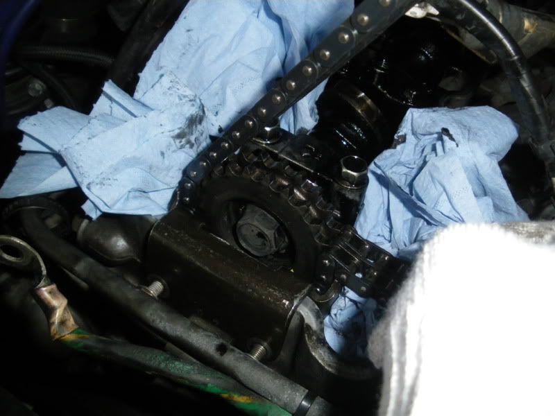

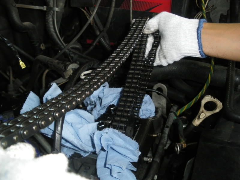

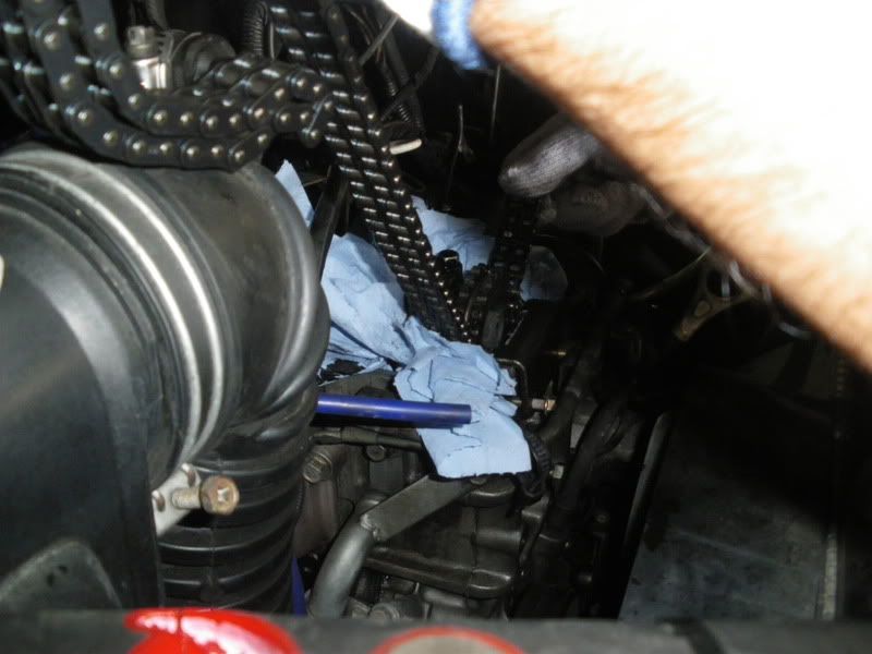

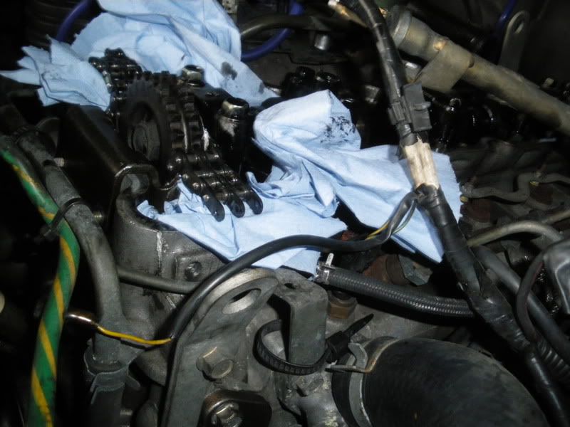

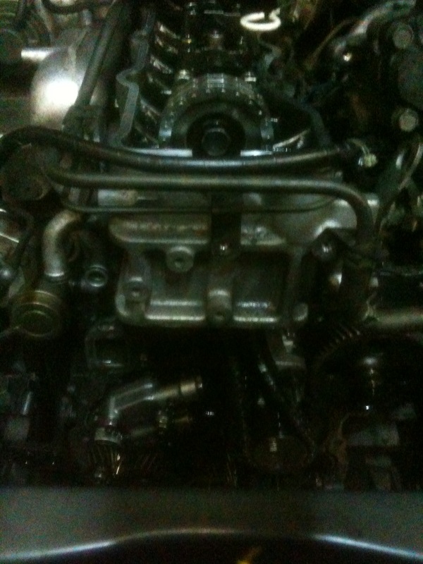

Since I havent found any picts of the L400 Timing chain, I thought I would post picts of my lwb royal exceed getting its timing chain replaced, as you can see its ALOT larger and beefier than the small timing belt in the L300 that is prone to failure. I will try to get all the picts in the proper order. The work was done by Mitsubishi Fuso in Japan, Its not a job that 95% of people would be able to do them selves as there is aparantly a couple of Special tools needed for it, and as you can see its a serious job

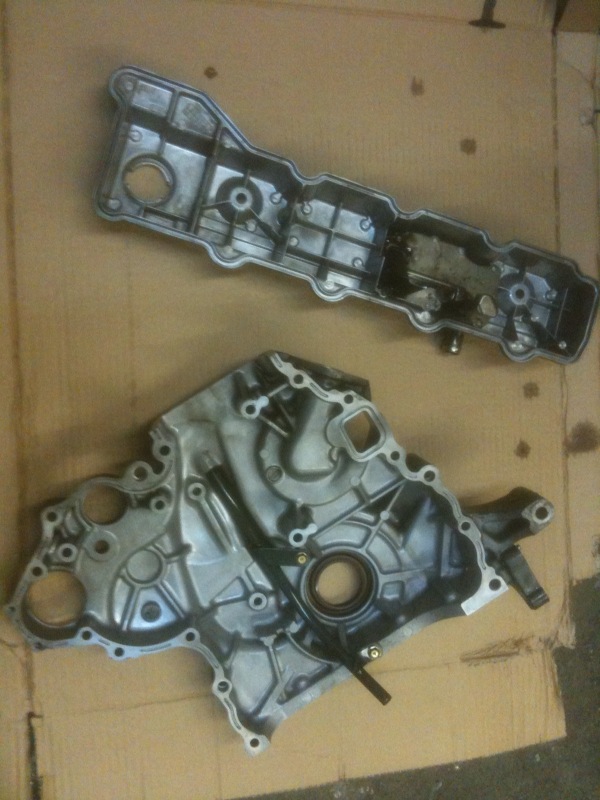

I prefer the one piece chain as opposed to the split chain shown here, less chance of failure, but it did require the removal of everything in front -grill, rad, condensor,water pump,etc.. but I did not need any special tools, I am however a diesel mechanic. If your chain guide and tensioner don't need changing, the split chain as shown can be installed without removing all the other stuff, and could be changed your self if you are a competent backyard mechanic. There are some excellent illustrated step by step posts of this on the UK site. Check these out and you will know if it is something you are capable of or not.

You can get the cover off without removing the rad.

jarang, you are right that the front cover can come off without removing the rad, the problem was I could not see the timing marks clearly, (even with my mirror) so I pulled everything out of the way to make sure everything was lined up 100%. However if you use a split chain, you don't need to pull off the front cover unless your chain guide is shot also. Simply link the new chain to the old chain and feed it through. I simply don't like the split chain because of a bad experience I had on a 1989 BMW 735i, somebody had installed a split chain in it, and the joining link failed. It's possible it was poor workmanship on the install, but I just prefer to make sure that wil never happen to me again.

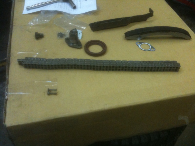

I bought the kit from rockymountain.
Single and dual roller timing chains, tensioner w/gasket, guides, crank seal and 2 chain links.
It came with a single chain and double chain as there are two types you can have on a 2.8
The new chain length was 2 links longer than the old original chain so it had to be shortened.

Full kit
Full kit
2 links too long
2 links too long

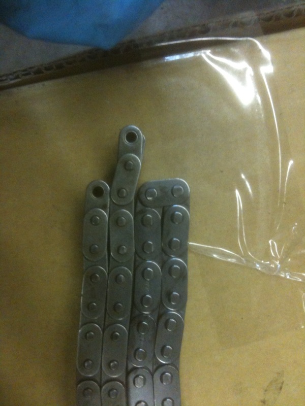

Old chain
Old chain
Covers
Covers

The revised chain links are more rounded compared to the 94 recalled chain.

Jesse - Got any closeup pix of the original chain links vs. the new ones? (Showing the "roundedness" you mention) Would be useful when looking at a chain in place on a vehicle to be able to see if it is original.
