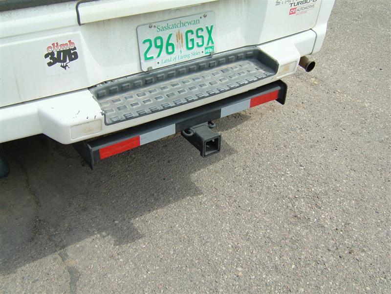

I found a welder just outside Saskatoon. (15 minutes) and
we spent about 3-4 hours and presto... beautiful hitch from
scratch. Nice, strong and beefy yet not bulky looking.
He welded all the joins, not just spot welds here and there.
It's bolted on in 8 spots (where the little tube bumper
joins on is two per side plus 2 others using 9/16ths
grade 8 bolts further back on the frame) We tack welded it to the frame as well.
My choice. My delica is a 1990 exceed so no stabilizer
bars to worry about although im sure we would have worked
with it.
Total cost - no tax $300
I would have tossed in a case of beer but I forgot to bring some.
I'm happy :)
Now to wire in some light hookups.
Anything fancy I have to worry about there? Standard tap into
the rear lights at the back?

Re: Hitch (yes another post about a hitch)
Just cause I want to :)
I will take out the spare tire and take a couple of pictures of the
hitch. I was super impressed and will get him to do any
other welding. I was talking to him about changing the foot
steps / cutting them etc. He showed me his pipe bending
stuff and I am almost tempted to get him to make a guard
for my air conditioning rad (standard tranny model) and possibly
a different push bar.
<insert.. bought wiring kit and wired it in - took about 15 minutes)
J
J
- 1/4 " plate. It's a solid hitch. Even the square tubing is thicker than what we were going to use. Just happened to be on hand :)
- spankyhitch.jpg (102.91 KiB) Viewed 4926 times

Looks good. Now you just have to survive bashing your shins for weeks until your brain finally learns to not have the legs try to occupy the space already occupied by steel.
- Firesong
- Posts: 1363
- Location: Saskatoon
Actually the side plates are in enough I don't bash.
And I prefer to use the hitch tube to step on to get up top.
No bashes yet.. Im still waiting to find the head gash point
on the exceed.
On my 74 VW I always ended up with a blood sacrifice to
the VW Gods. Had a nasty little bolt that would catch my
scalp when sticking my head into the engine compartment.
The hitch worked great last weekend.
Had to get some parts for the VW out of the parts van for
the new owner. Loaded a 2 liter pancake motor into the back
and an automatic transmission onto the Princess auto basket
hooked to the hitch. After 250km with some back roads tossed
in the hitch never sagged or gave any indication that it was
having problems :)
Totally happy with it.
James
