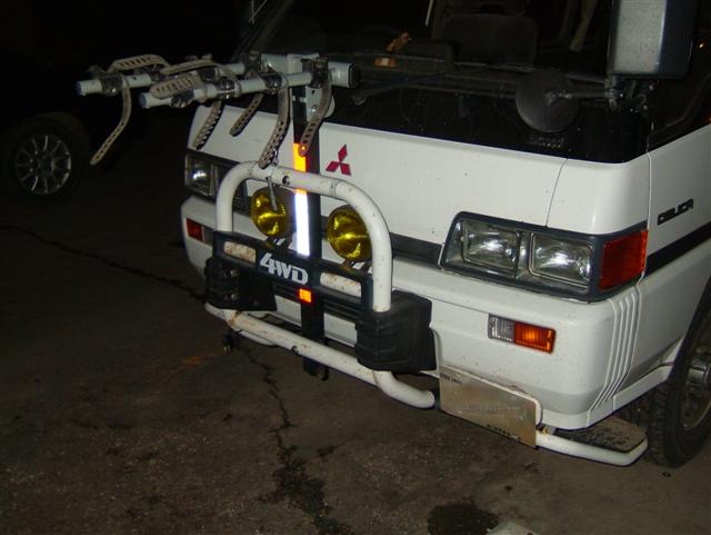

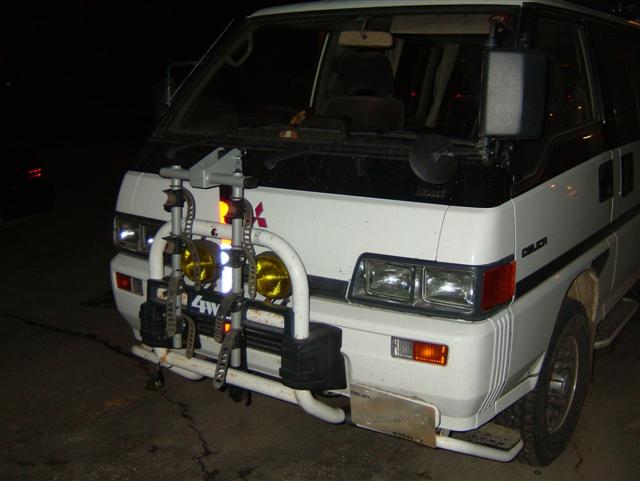

I've been wondering and wondering how to set up the front
to handle a few bikes. I haven't installed a tow hitch/bar in the
back yet which would fit the 2" bar on the bike rack I already
own. When you have to pack up 4 bike for kids and possibly
another 2 for us adults it adds up quick. I got to thinking about
the front push bar and remembered someone saying that there
isn't anything strong enough to really put a receiver onto for
anything to strenuous. So I ended up thinking that if anything
goes on there it will only be a couple bikes.
My bike rack is a swing down, swagman 4 bike style. 2 prong..
I almost put a reciever on the push bar to allow me to slide the
2" bar down into. Meant welding the receiver vertically behind the
push bar tubes. Since I don't own a welder and didn't feel like
buying a receiver I went for the next best thing. 3 grade 8 bolts
through the tubes and the bike rack is on. I took the bottom of it
off that goes horizontal so it only had a vertical bar. Finally got
it done in the dark. Looks really good and quite stable/secure.
The height should work out perfect for the top of the bikes.
I had put the red/silver reflector tape on it last year and looking
out the window of the house it sure shines well.
Just an idea for those who want to haul bikes in the front, a basket
in the back hitch and not stick bikes waaaaay up on the roof.
Although I still might have to so as to accommodate 6 bikes :)

- bikerack2.jpg (46.33 KiB) Viewed 10838 times
- Folded down.
- bikerack1.jpg (44.21 KiB) Viewed 10839 times
