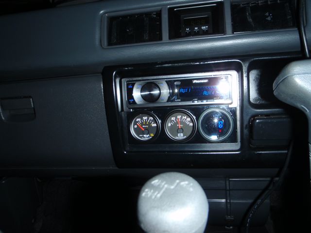

I mounted my gauges under the radio as they just fit..
I have oil pressure volt and a combo pyro/boost.
The gauges are 2 inch.
The oil presure is the most usefull as the stock oil light only turns on at 3-5 psi long after the engine has sustained terminal damage.
The pyro and boost gauge were quite usefull in the past but with my new injection pump which is back to factory settinngs you cannot get the pyro temps to high anymore.. but the van is slower!
The boost never use it.. and the volt meter is good for camping as you know how long you can leave the lights on without jumping..
I went with Equis for the oil pressure and volt at i am not all that concerned about 1/16th of psi or volt accuracy and glowshift for the boost /pyro as it was the only 2 inch combo gauge i could find.
