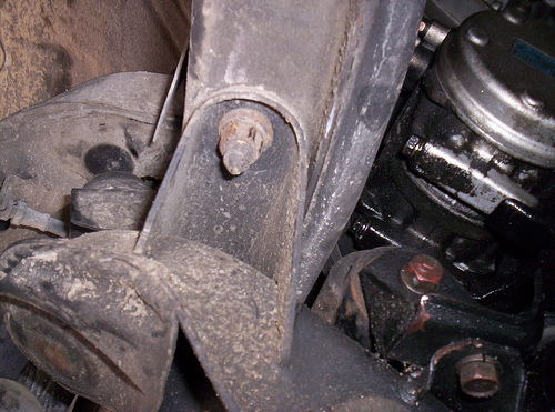

Well, I don't have a clue as to what I'd be looking for underneath, but I do, however, have a few ugly sticks. Got a pic or a diagram as to which bolts are the 8 lucky ones? I'd like to try those before I take more drastic measures.... cheersjrman wrote:Glen at CCAutos advised to crank down on the 8 front subframe bolts with the biggest ugly stick available.
Well - I tried, but clearly my own arms and/or ugly stick weren't good enough as the noise persisted. So, Nathan at RJD in NVan did his magic along with the necessary and advised copious application of "never seize" and thus, my 18 month headache is solved. No further noises up front......... smiles! Good luck.

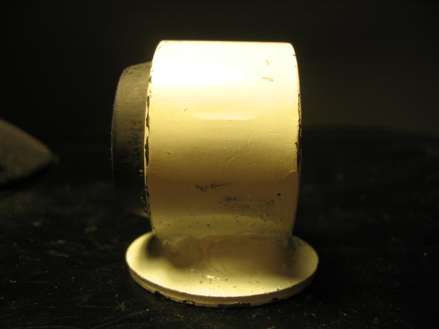

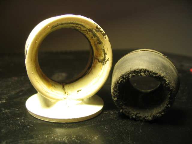

I had a horrible knock coming from the front end of my van when I first got it. Took me a while to figure it out cause it was very inconsistent. I believe it was the the bolt for the "lower control arm"... not a hundred percent on that though. I will try and take a picture of the one I tightened tomorrow and post it. For me the clunk never came back after tightening it. I also had another clunk not to long ago which turned out to be the lower bushing on my front left shock. There was a bur in the "eye lid" which cut through the bushing. Replaced the bushing, clunk was gone.
- Where the other half of the bushing went to is still a mystery to me...
- IMG_8192.JPG (93.7 KiB) Viewed 6348 times
- This is also my second Procomp shock that has failed on me
1st The knuckle in this picture busted off the rear shock while driving on the Hwy, causing it to slam into the floor board.
2nd The bushing disappeared. - IMG_8191.JPG (129.34 KiB) Viewed 6348 times

Photo courtesy of bcdelica at following post - http://www.delica.ca/forum/clunk-bang-f ... 20-15.html - I believe they are 17mm and there are a total of 8 altogether.
- Subframe Bolt.jpg (160.97 KiB) Viewed 6316 times
