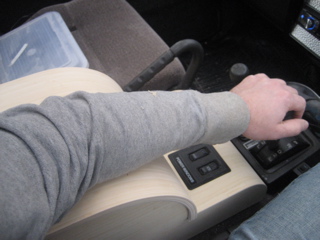

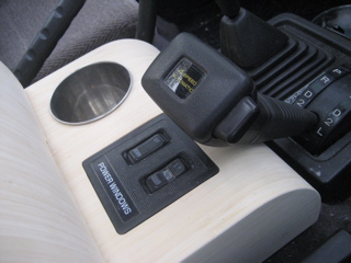

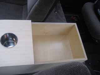

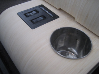

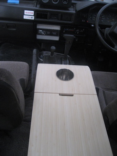

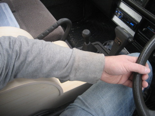

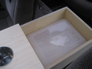

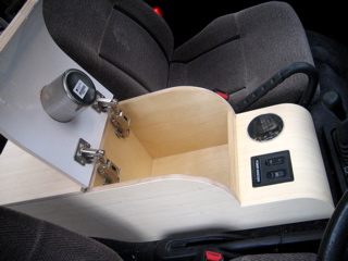

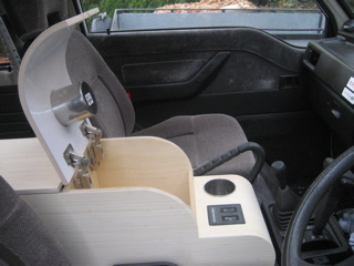

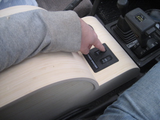

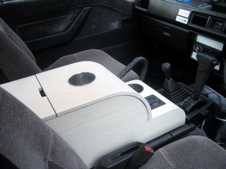

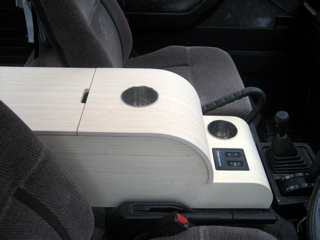

I've been making some progress on the console, here are the results. Although this one isn't quite finished, all the major issues have been worked out. I was disappointed that it so difficult to fit in two cupholders and the window switch on the lower section, and still have a comfortable spot for an armrest. On the plus side, this arrangement allows for a bigger storage area. I mocked up several different layouts before settling on this final one.
So, there are two separate storage areas. A smaller one up front, and the larger one in back (no hinges yet). The rear one is about 9.5" x 12" so it can easily fit most magazines, map books, etc. As a bonus, many off the shelf storage containers can fit in here. I have one cupholder on the top, and one down below. I like to use the one up top, it's an easy reach while driving. It is slightly higher than the armrest on the door, and I feel a bit off balance with this, I think I would make it a little lower next time, but that can be up to each individual. All in all, I'm quite happy with it and will finish it off this week and take some final pics.
Anyone interested in one let me know. I think the price will be about $350, depending on how many I'm making (economy of numbers). I'm not asking for a commitment from anyone right away, but I just need to get a sense of the scale of production. I will finalize a price when I make the first two - I don't have a very good idea how long it will take to make one - I spent a lot of time on this prototype working out details etc.
Last thing - they will be available in bamboo (shown), Cherry, and Wenge.

I am definately interested.
Do you have any swatches you can take pictures of for the different materials/colors?
Being uncultured as I am I have never heard of Wenge and I don't want to tell you what I think it looks like.

Post by quadzilla »
That is looking pretty sweet, Glenn. One observation, though - it looks like it may be a tad awkward for those of use driving a manual. From the photos it looks like a fairly high profile unit - much more so than the original one in the Delica - any chance of a lower profile unit?
