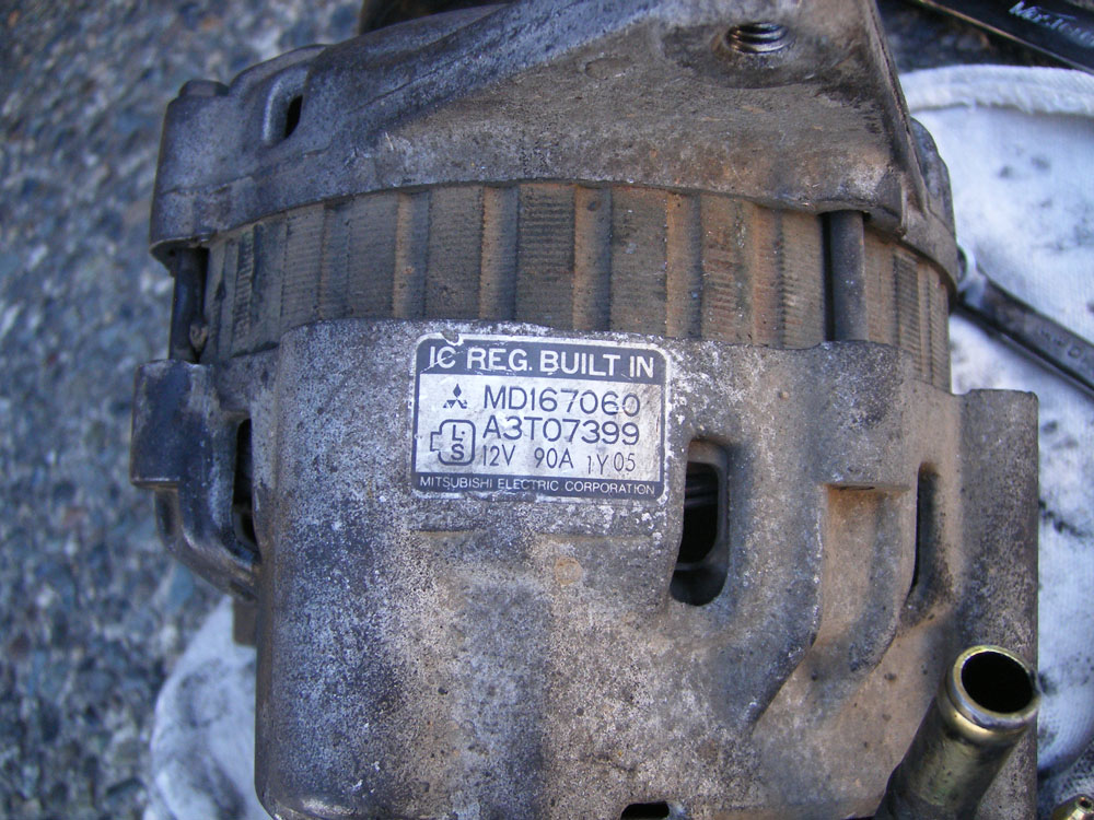

jfarsang wrote:Also the Mitsubishi Delica's did NOT come with 90A alternator's.
Really??? Looks like mine did.
90A Super Exceed Alternator 1991
Try Coombs Country Auto (CCAuto) if you can't find anything locally.
Re: Need Alternator ASAP
Silly me. :?
S. Exceed/Chamonix/Jasper's with winter packages came with the 90A :M Just checked mine as well.
