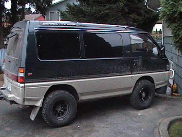

i went to north shore off road 50$ four black steel. pretty nice got my 30" muders on now looks pretty cool. Wheels 15x8 3.75 backspace 6x5.5, mudders hercules trail diggers 30x9.5x15. Had to break out the grinder and take some panels off to make em fit.

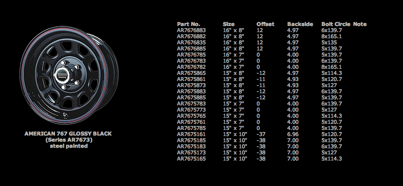

Want some black steel rims from American Racing, but I'm wondering if this model even fit with the standard tires size (LT235/75-15)
Any idea?

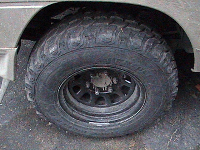

heres the tires and wheels i put on just did i side exhaust no muffler to, kinda quite! JK. but i like the lack of back pressure
