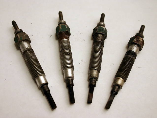

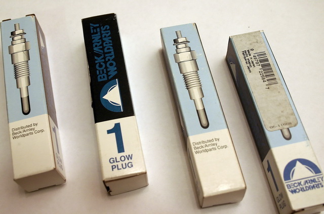

Well done dear Delica fanatics. Thanks to all of you and Glen from CC Autos who I talked to later today I came to the conclusion that the most likely cause were glow plugs. Of course that was the most desirable scenario for me. Several hours and $48x4 (left in Lordco) later the engine happily performed an easy and a smoke free start. Another replacement done successfully. How many more ahead? Looking at the difference between the new and the old plugs I was shocked
Here are some pictures. Sorry, no special recommendations: used a 12 mm socket to unscrew the original plugs easily and put the new ones in. It took less than 30 minutes and a glass of red wine. I think we have to review the 'must do' initial maintenance list but this is a different thread.
Cheers!
Sergiy.

- New plugs.
- IMG_2993_1_resize.JPG (80.09 KiB) Viewed 7352 times

- Old ones.
- IMG_2997_resize.JPG (75.82 KiB) Viewed 7353 times
