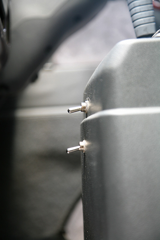

Switches
Switches
Here are the two switches. The top one is the main controller and the bottom one is just a kill switch for the svo heater.

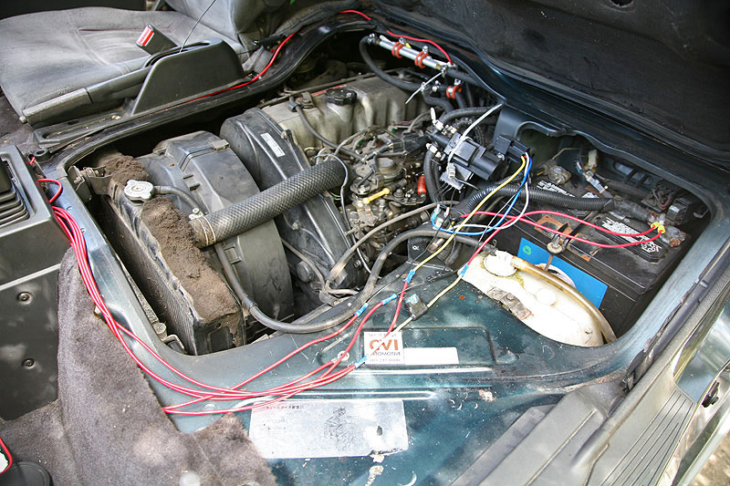

The engine complartment
This is the main part of the installation. The wiring had me confused for a while, but now everything works great. But there is no buzzer and the heater will run with the van turned off. The buzzer will be easy enough, I just have to find the accessory wire for the one side.
I was really suprised at this install. I was expecting lots of problems with airlocks or other fuel line things. However when we did the test run, the van started immediately on diesel and kept running once switched to SVO even though the heater was switched off because I had the kill switch backwards.
There was one small problem at first, we revved the engine on SVO and it stalled a few times, but we thought it was partly an airlock that we worked through and a hose started pinching off (which may have happened from some vacuum pressure on the inside of the line).

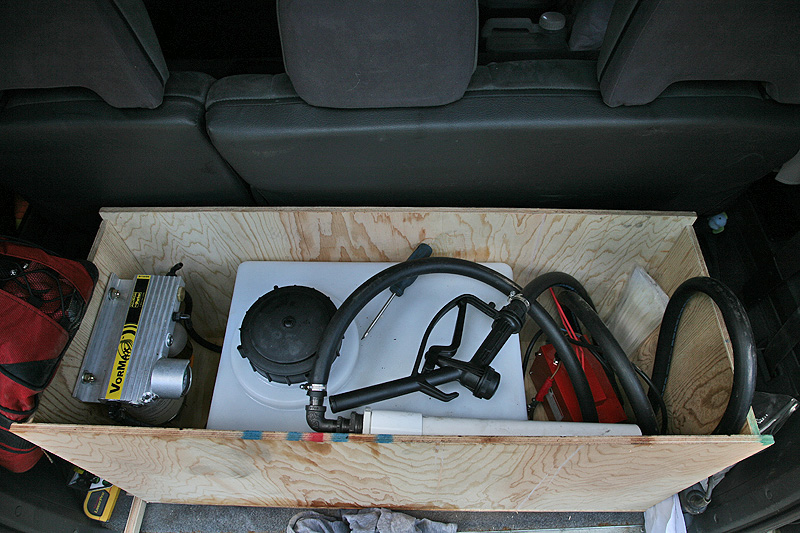

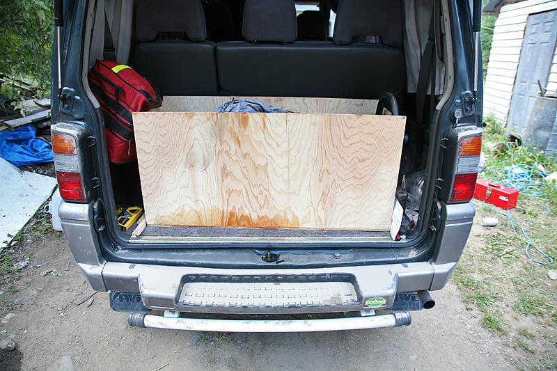

SVO tank box
SVO tank box
To keep everything simple I just built a plywood box to house the plastic tank and vormax filter which is too big to tuck anywhere in the vans engine compartment. Then I drilled holes in the floor to run lines to the front. And then promptly spilled oil all over while hooking up lines to the filled filter and then again while filling the tank.
SVO tank box top view
Top view.

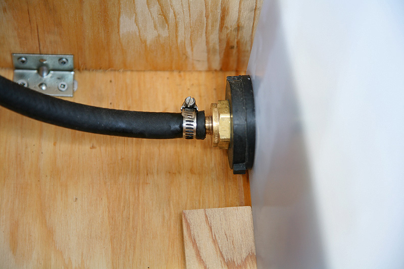

SVO tank hose connection
Here is the connection to the tank. Just some items I found in the local hardware store. My friend who helped me had a great idea as well, there was a screen that came with the transfer pump/filter wand combo that wasn't being used because the filter wand took its place, so with a small bit of hose and another 40 cent adapter from the hardware store we added the screen to the inside of the tank connection, which is threaded on both sides. Just another thing to help stop crud build up in the filter, and it may prevent the "glob of grease" scenario depicted in the instructions from plantdrive.

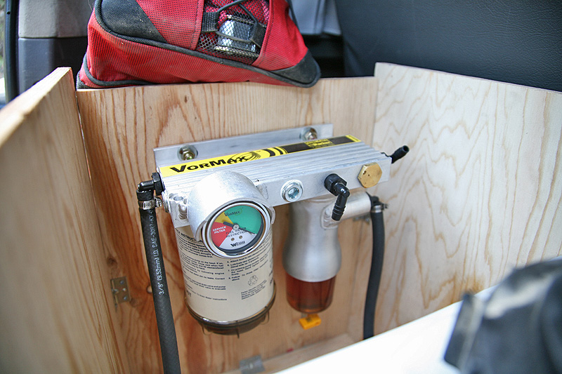

Vormax Filter
Vormax Filter
Here is the Vormax filter, I have not yet hooked up the heat to it as the installation took longer than I expected. I did drill the holes so I will just have to cut some lines and add it before labor day (as suggested by plantdrive when I emailed and asked if I would be okay for summer with no heat to the filter). I think that I will use the coolant lines running to the rear heater. Has anybody done this at all?
Anyways, the installation was very exciting right at the end when we were finally running on the blood of innocent plants and tearing through logging roads. I have to bolt my plywood box down. I forgot to do that!

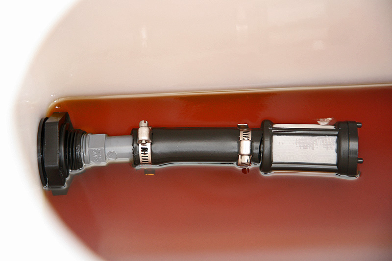

In tank screen
In tank screen
Here is a picture of the screen in the tank. I did take it close to the limit running this low, but if I get an airlock it's no big deal.
this begs the question: does coolant run to the rear heaters when they are not turned on?
Re: My trip to Cherryville (to install my WVO system)
Check out PlantDrive blogs on their Delica install. I'm pretty sure they connected their lines to the rear heater. You can always crawl under and touch the lines for the rear heater when your van is at operating temperature, that would confirm my guess that coolant is always routed there.

delicat wrote:You can always crawl under and touch the lines for the rear heater when your van is at operating temperature, that would confirm my guess that coolant is always routed there.
Done, Heater was off and the lines are hot.
