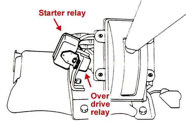

Right - sorry it took so long to get back to you, but I have managed to track down the info that might be helpful to you?
Below are some images that show the location of the OD relay (inside the selector console) and also the OD wiring harness and solenoid at the gearbox end. I would check to see that the wiring has continuity from the switch to the relay and also from the relay to the wiring harness?
Check the connections at the gearbox end and worst case scenario, try and swap over the OD relay with another L300 owner to see if it might be the problem? If not, you might be looking at a solenoid problem?
Check the wiring first, then the relay, then the solenoid.
If you like, I can email you a full wiring diagram for the OD circuit (genuine mitsubishi diagram!)
Best of luck with it and let me know how you get on?
Bruce.

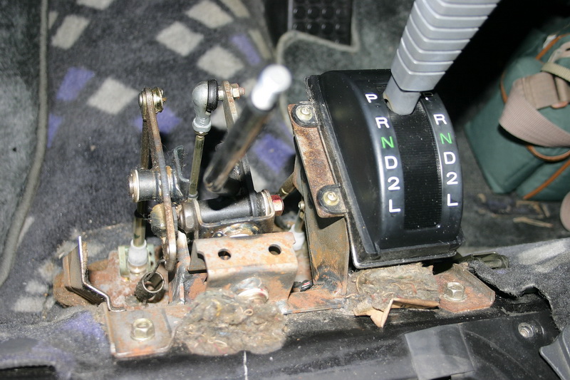

This is the latest report on my troubleshooting following Bruce's recommendations. The picture shows that there was no relay found where it was supposed to be if the troubleshooting info was correct. Judging by the other technical posts on this forum I can imagine that the factory can change some details without documenting them for the public and the relay in my truck is located somewhere else. From the other hand the voltage on the solenoid connector goes on and off if the overdrive on/off button is pushed which leads to the conclusion that most likely I have to blame the solenoid for the 'overdrive off' malfunctioning. I have to find out what to do next I guess; well, I know what to do but I have to find a solenoid replacement to try.

I'm really glad to hear you got the OD sorted. I'm sorry about the wrong info on the relay....I was working on the new Mud Monkey the other day and I had the cover off the gear selector. I straight away noticed the lack of OD and starter relay and it really pissed me off that the info I have is wrong!
Despite the fact I had the cover off for something completely different, I was determined to find the relays....just so that I knew for future reference etc...
I found the starter relay - it's located under the service hatch behind the drivers seat, but I still can't track down the OD relay! I'll not give up looking though - I NEVER give up!
Anyway, glad you're fixed and running good. A happy ending.
