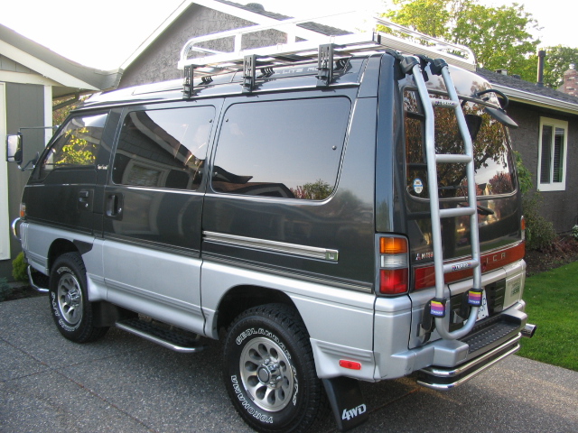

We have done mileage checks in our first 3 tanks and come up with a respectful 23.5 miles per gallon(city)Not bad for a tank on wheels ! Looking fwd to running down to oregon next month on I-5 to compare. I see that the usual config for fuel tanks on these vehicles is 1 60 ltr and 1 10 ltr in series. We have only filled up 3 times since we bought it and have yet to fill over 47 ltrs.That was with the low fuel light on for aprox20-30 klm.(Dont have the guts to try furthur than that!) Maybe we have a oddball tank or a huge reserve of 20 ltrs.Also we are getting alot of black smoke on acceleration but I read thats the nature of the beast.It flew through aircare and seems to be running great.(The smoke screen is a GREAT tail gate deterent ,3/4 throttle and people seem to back off in a hurry) Any imput on the fuel capacity would be appreciated (Ive read all the black smoke forums and dont think I have any thing to worry about) will be taking it to cvi soon for a tune up before our trip. Thanks Paul M.
