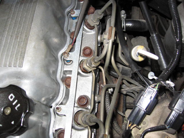

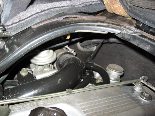

Easy done - just look for the water pipe from the back of the head/top of the block at the rear which follows around the side of the block and across to the turbo.jfarsang wrote:I'd like to take a closer look underneath at the turbo to confirm yours is the water-cooled version. Shoot me a PM.
Water cooled ones tend to have less oil lekas because the bearings wear much better.

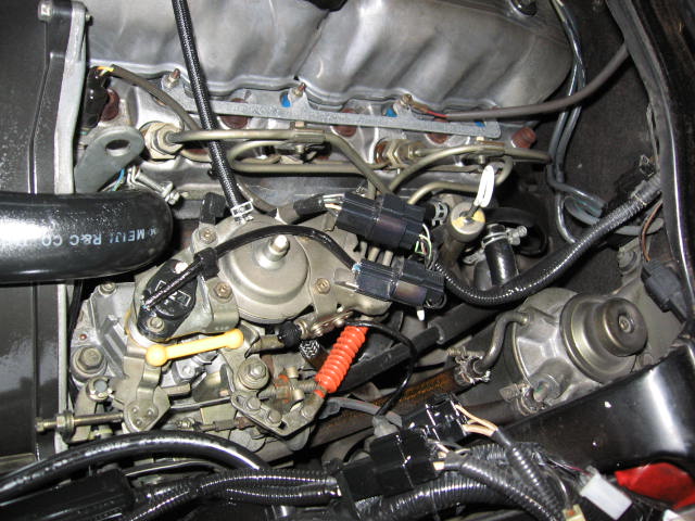

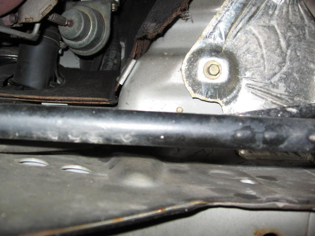

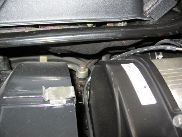

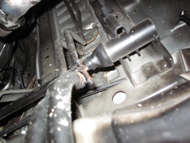

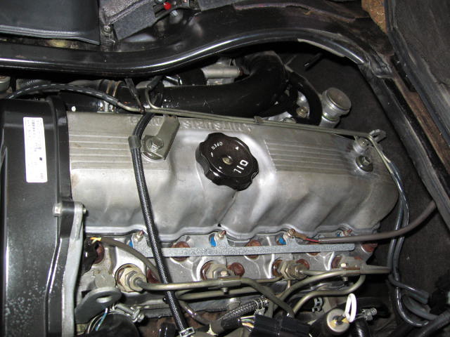

Now if I only knew what the head and the block were, and where the turbo was, I could do that. Instead here are some pictures of the engine (including two lame ones from underneath - it was raining and I didn't want to get my clothes wet by kneeling, what can I say). The first two are from underneath, sort of...Mystery Machine wrote:Easy done - just look for the water pipe from the back of the head/top of the block at the rear which follows around the side of the block and across to the turbo.jfarsang wrote:I'd like to take a closer look underneath at the turbo to confirm yours is the water-cooled version. Shoot me a PM.

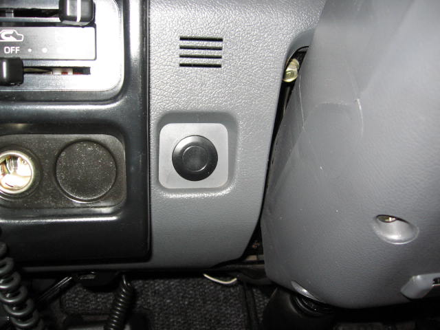

I also took two of where the throttle cable adjuster is supposed to be - one with plug in and one with plug out, which I'll add next post.
You tell me if there is a water pipe somewhere. I have no idea.

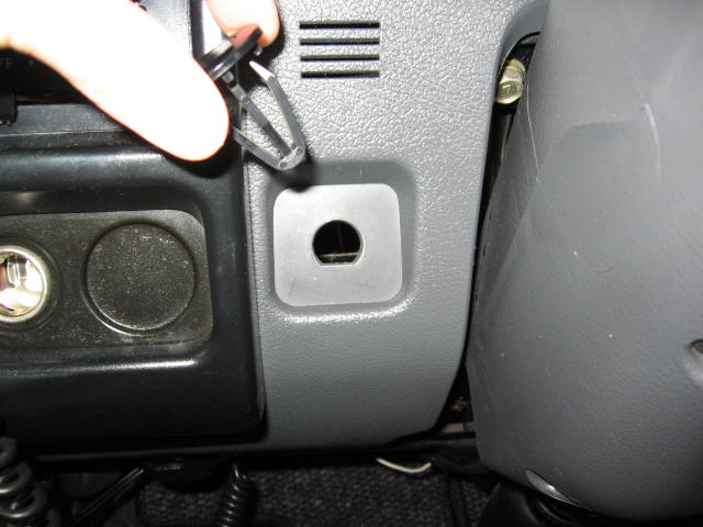

The lack of throttle adjuster.
- IMG_2148.JPG (48.2 KiB) Viewed 4838 times
- IMG_2149.JPG (47.1 KiB) Viewed 4839 times
