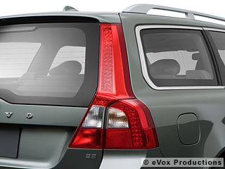

Personally, I don't like the one which came with the Delica (although Moon Machine as a 1990 doesn't have one). I don't think I've seen too many of these high mount brake lights that actually enhance the look of the vehicle. I find the light a bit silly anyway, especially on the Volvos and the Pontiac vans which have very long tail-light assemblies mounted high on the side pillars of the rear of the vehicle (like this):
I mean, does there REALLY need to be a light in the middle of the car to indicate that the car is stopping when there are tail-lights that big on either side of the car?
yes, but only because some idiot decided that north american vehicles would be allowed to use red signal lights in the rear... if we had to use amber ones like the rest of the world it would be obvious without the extra light!
