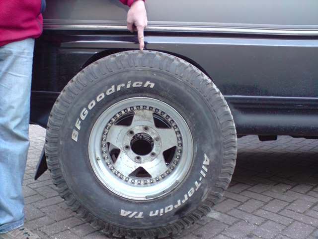

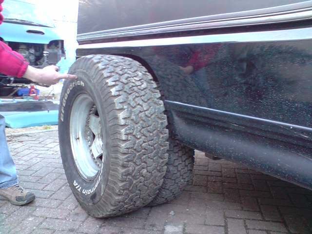

I'm gonna see if I can squeeze these puppies onto the new Mud Monkey without having to lift it too much!
Might mean a few hot dates with my grinder though??
Re: Expedition Delica pt1
Mystery Machine wrote:I'm gonna see if I can squeeze these puppies onto the new Mud Monkey without having to lift it too much!
33's from a landcruiser ? Looks like the same offset.

33's form a Land Cruiser work. Those are the 33 x 9.5's that I had on for a day that fit great. Not many manufacturers make that size so I am going with 235 85 r 16. Less cutting and issues with skinny tires.

docsavage wrote:33's form a Land Cruiser work. Those are the 33 x 9.5's that I had on for a day that fit great. Not many manufacturers make that size so I am going with 235 85 r 16. Less cutting and issues with skinny tires.
James
I hear you. I scraped this morning. Need to take the BFH and do some more *cough* modifying.

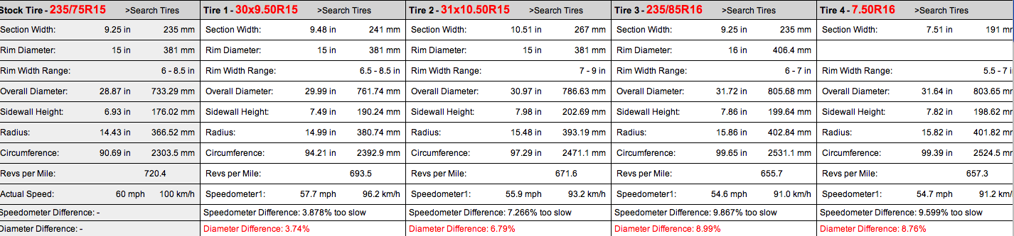

Just for the fun of it I've attached a chart showing the difference between some tires mentioned on this post as well as some other options... Here it is:
Tires size comparison.png (67.64 KiB) Viewed 11376 times
David

David, the chart is a good comparison but the only thing it leaves out is the difference in 'actual' diameter between all terrain's/all season's/mud tires. You can actually have almost 3/4 " difference in diameter between the three.

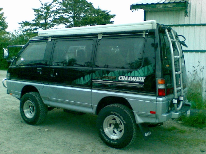

Superwinch Manual hubs - on
Nice foldout awning - on

Awww man....that awning is wicked. I gotsta find me one of those.
Where did you pick that one up?
Very jealous!

could you show some detail please on how the awning attaches?
