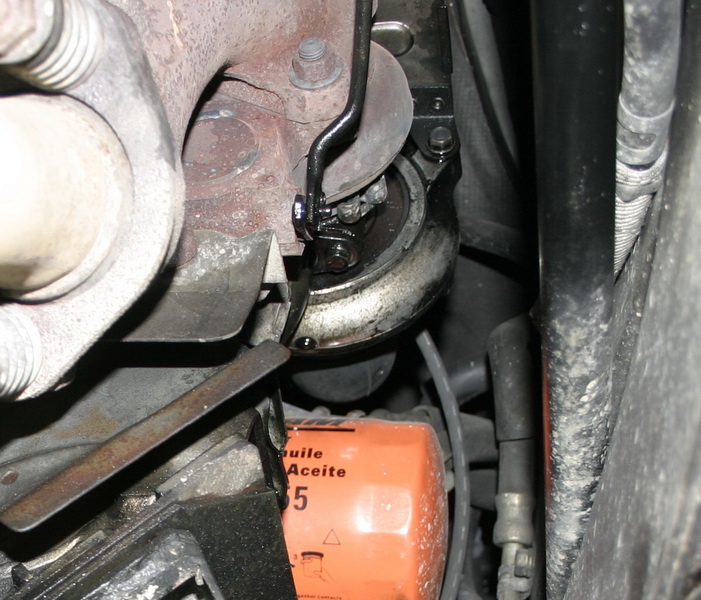

Re: dripping oil of the turbo?.........is it a normal thing?
Here is my turbo leak. Documented
Don't panic; it does not reach the ground.
- IMG_0413_resize.JPG (162.74 KiB) Viewed 4965 times
yup thats what mine is like although my engine is dirtier than yours :) I get the sad little drop of oil right there on the bottom of the turbo.
