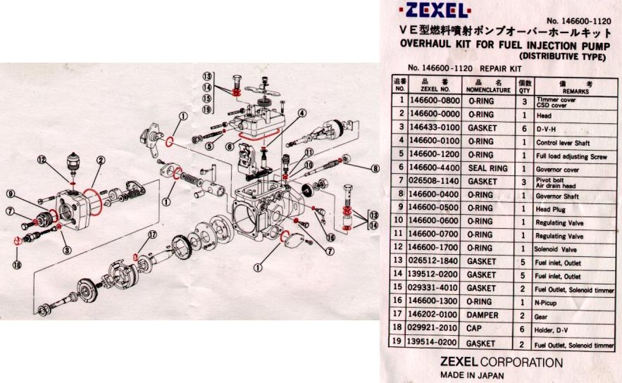

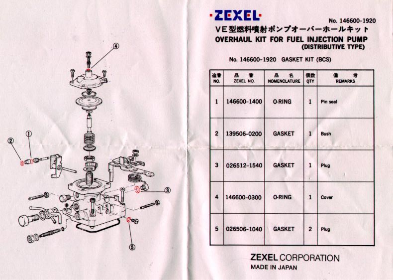

Re: Injector pump tips and tricks
Don't try this at home.
Notice the top is different from ours but the body is the same, including the rectangular governor seal. In a pinch you can get parts from a VW Jetta diesel. I'm going to check the Jettas next time I'm at Pick n Pull and grab one of these puppies for $20 to play with. No loss if I destroy it.
Our pumps are labeled Zexel, just a Jap copy of the Bosch. Came across these excellent diagrams after I no longer needed them.
These might help someone in the future.
Bob in Kelowna
Bob in Kelowna
- ve_ldakit.jpg (111.66 KiB) Viewed 34198 times
- ve_mainkit.jpg (141.58 KiB) Viewed 34961 times
- This is the pump ours are based on. Rather than re-invent the wheel the Japanese took a patent option on this reliable German pump. Variations of this pump are used in many applications by many manufacturers.
- bosch pump.jpg (230.58 KiB) Viewed 34292 times

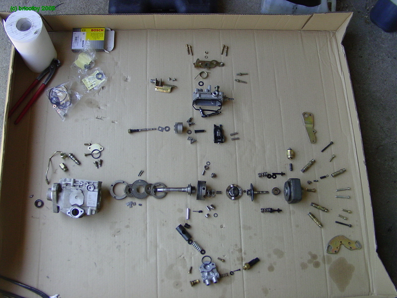

Those are Volkswagen pumps, the diagram came from a VW related web site. Ours pumps have very subtle differences. All are the Bosch VE type. The biggest difference in all of them is between the turbo and naturally aspirated engines. The tops are very different. The top seal is the same in all of them though. The rectangular looking seal. It fits in a channel in the top and is supposed to protrude slightly from the channel so that it makes good firm contact with the machined surface on the base when bolted down. Mine didn't show outside the channel at all. It seems to dry out and get hard, shrinks a little and doesn't make tight contact with the surfaces. It's a little tricky getting the top back on right without changing the volume adjustment screw, but there is a way without changing any adjustments as I finally found out. After doing it over and over again it seems so simple now. Moving that volume adjustment screw just a quarter turn makes significant changes in the way the engine runs. Now I know why they said not to touch it.
I'm suffering from a horrible cold the last couple of days, but I have pics of what I did and will post with all the other information I found as well.
Bob in Kelowna
Bob in Kelowna
