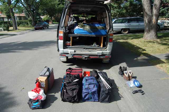

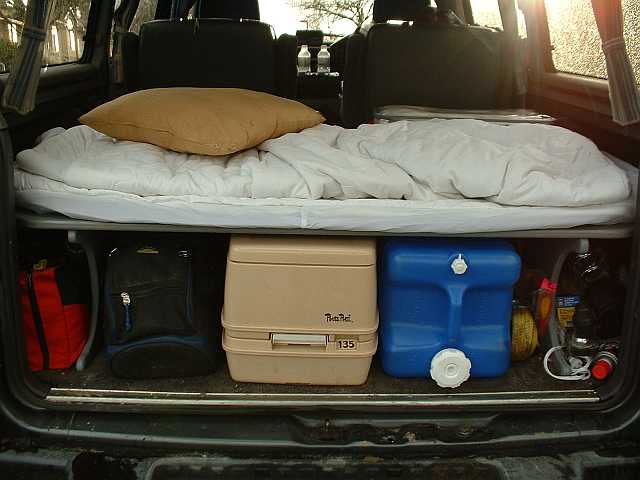

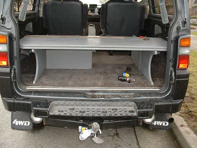

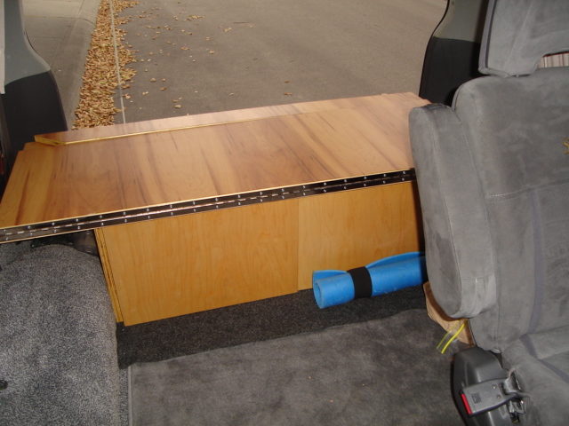

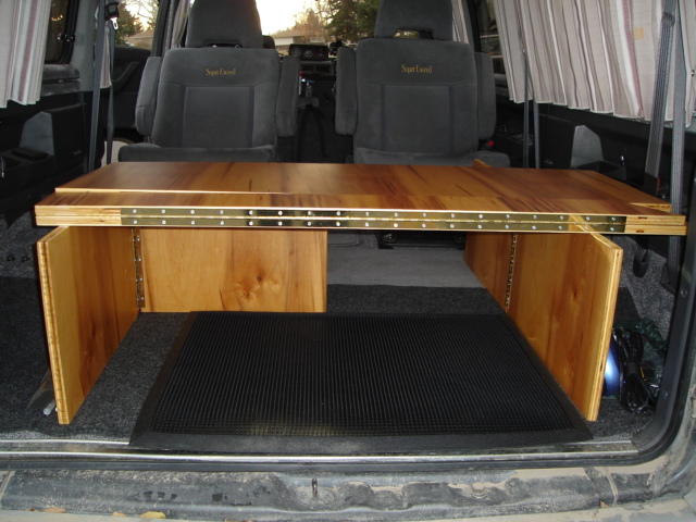

Hi all Deli-sleepers, am now attempting to attach photos of the storage box / camping bed base that replaced the rear bench. Fingers crossed. Written Details previously on this post.
Height underneath is 12.5 inches (milk crate height). 40 inches from back to front (both halves 20 inches). Width is delica inside less about an inch each side so seatbelts can pop up to secure box.
Total bed length is 2 metres. We have slept several winter weekends. Bed very comfy even for 6'3 Jay, with walmrt queen airmattress (not the double height or you're sleeping in the glass window portion). Double sleeping bag to keep warm underneath you. Get polyester fleece pillowcases, so don't absorb damp air -- no cotton anywhere to avoid dampness. Don't need to fill in the hole between captains seats (or put the headrests of the captains chairs there).
Bed box can be left fully opened, with foam or slightly deflated airmattress bed folded in half (with all bedding made up, and folded in half, held down by bungee, ready to drop the captains chairs and flop open the instant bed). This way the captains Chairs work fine for passengers, or for Picnic mode when you want to warm up and relax at lunch between ski runs.

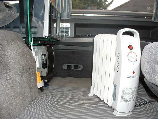

Mini Oil Heater 500 watts, Canadian Tire. Runs when we're plugged in at home so carpet and van is dry to start off. Runs off the inverter while we're driving to keep everything toasty warm, sits happily between the 2 captain chairs without tipping (safe even if tipped over, check to ensure yours is properly sealed from factory for no oil leaks). The heater sits on coffee console when we sleep, drivers seat empty always ready to drive away if bears visit. Make bed before going winter camping as dark early, and we can just slide over the coffee console into the rear without opening doors to keep out cold air. OK, I will admit to the electric mattress warming pad ($8.00 Valu village find), runs while we drive to keep bedding warm, but I have survived without it on logging road pullouts.
Microwave 800watts runs just a few minutes to heat up pre-cooked or canned dinner on each plate, can run the delica engine to ensure no battery drain (we use a single 27 series battery). Charger mounted beside it, plug in extension cord at restaurant / gas station / camp ground restroom to recharge. Thermos of boiling water sits above microwave with tea & hot cocoa & cookies & stuff ready for snacks/breakfast.
Guys, if you want your S.O to enjoy the delica life, most women agree on the things needed. Porta-potty (no shared toilet with strangers) hidden between the deli and a bushy tree for privacy, that can be emptied when a nice clean flush toilet is finally found. Warm fleece blankets (not just a sleeping bag, need a fleece blanket each to wrap shoulders and arms, not a shared fleece blanket that the guy steals). 2 thermos' of instant hot water in the morning -- no waiting till the stove is lit. Doors that lock (no tents where Nutters can visit with machetes). Curtains on the windows. Yes, the inverter for the heater would be nice, but the other stuff is crucial.
I have more photos, PM if you want more details. Send me your real email ID, as too painful to reduce the photos.
Cheers, Christine of the TardisDeli,
with grateful thanks to Jay Of The TardisDeli who continually finds ways to fancy-up the Tardis.

- Ready for weekend, beige porta potty is the crucial 12.5 inch height underbox, height was determined by captains seat.
- Ready weekend, beige PortaPotti crucial 12.5 in height.JPG (30.62 KiB) Viewed 19518 times

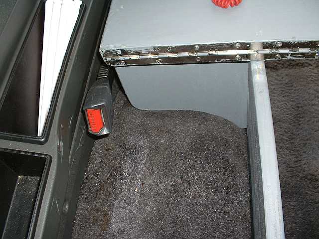

- Detail of wheel arch freehand curve, photo from passenger seat.
- detail of wheel arch curve, photo from passenger seat..JPG (40.06 KiB) Viewed 19518 times
- Folded lid in half, left leg folded in, next fold right leg to create smaller box.
- Folded lid in half. left leg folded in, next fold right leg to create small box.JPG (40.48 KiB) Viewed 19497 times
- Cdn tire 500 watt oil heater, 800w microwave. 1000w inverter.
- Cdn Tire 500 watt heater. Microwave. 1000w inverter.JPG (40.91 KiB) Viewed 19609 times

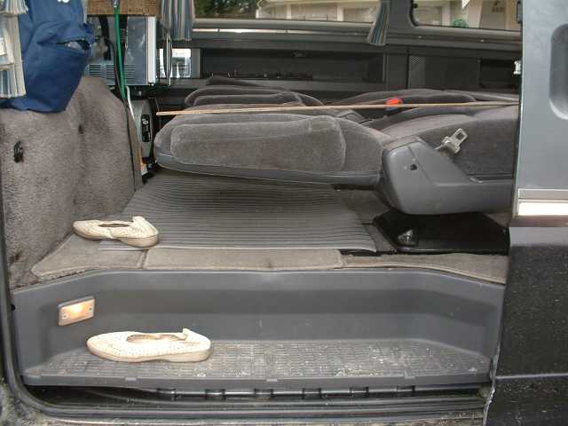

- Bed mode. Shorter person sleeps door side so room to step in and out.
- Bed Mode. Shorter person sleeps door side so room to step in out..JPG (29.25 KiB) Viewed 19488 times
- 2 metres total bed length. Note seat belt ends on wheel arch could anchor box.
- 2 metres total bed length. Chair height determined box size..JPG (30.48 KiB) Viewed 19574 times

Thanks for the photos. Gives me lots to add to my million and two ideas on how to make my version.

how long does the bat hold up running the 5 hundo watt heater, is it on the same bats as the starter?
or you run it on a seperate circuit?
looks rad im thinking of all the useful hot things i could make in that microwave. EGGOS!!! mmmmm

It's all a matter of simple OHM's Law, and the amp hour capacity of your battery(s).how long does the bat hold up running the 5 hundo watt heater
Let's say you have a battery with 150 AH capacity. The 500W heater would draw at least 42 amps if the inverter were 100% efficient (which it isn't). So your battery would be dead in under 3 hours. In other words, you cannot run a heater off your battery, you need to have a generator or be in a campground where you have access to mains power.
Also just to provide a frame of reference. I run a 900 Watt Heater in the Deilca. At -5C you can get by with warm clothes on. At -10C, it is not very comfy for sitting around but is OK for sleeping if you have warm bags.
The problem is our Honda Genny only lasts about 6 hrs. So you always wake up freezing. (In addition, DO NOT sleep on an air matress unless it is topped with ensolite or equivalent). Some people have modified their Genny's to take an outboard tank, that's on my priority list for this winter.

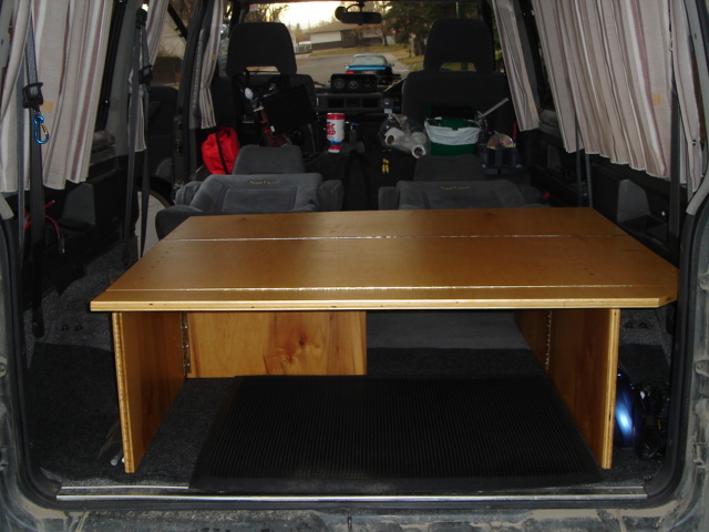

Finally I have a chance to post! My sleeping platform is modeled on TardisDeli's, but with some differences. Built for comfort and storage space on a 33-day trip to Inuvik.
It folds to 1/2 length, with the sides folding too. The second row seats are slid all the way back. In daytime they can be faced forward and seat two. Here it is in folded position (with one "leg" open) The photo below is with most of it in sleeping position (only one "leg" is still folded). Note that the top folds down at both the tailgate and most of it folds forward. The seats, slid all the way back and facing back, are folded down, touching the platform. Headrests can stay on. Note that the platform does not go full width. It is 48" wide, with a corner cut out to clear the tailgate corner. The platform sits tight against the tailgate. The 4" folding edge allows one to reach down to reach the tailgate latch. Our mattress is 41" wide 4" thick foam ("twin" size), so there is room beside the mattress to put a book, flashlight, etc. I also put large sheets of that no-skid rubbery mats under the mattress so it won't slide. This shot is from inside looking back, with the platform folded. The missing triangle from the rearmost section hasn't been attached with a removable hinge yet. I didn't need it on the trip, and it isn't a high priority right now. Just folding the 3rd row seat flat works quite well, especially if you use an air mattress. The main reason I made the platform was to gain storage space. Under the seat is only 6" high, under the platform is 13". This photo shows what was UNDER the platform: The pile in the middle was under the platform between the sides. Went from the back all the way to the 2nd row seats. The boots and other stuff on the sidewalk was under the platform between the side of the platform and the side of the Delica. The stuff on the left (fire extinguisher, etc.) was beside the platform on the passenger side. Only the grey case stuck up above the level of the platform. In this photo you can see the no-skid under the mattress, and see that the mattress is narrower than the platform. During the day, the mattress was folded in half, leaving the 2nd row seats usable. On our Inuvik trip, the platform was never folded, only the mattress. At night our fleece jackets were on the 2nd row seats under the mattress to level it out some. And my computer brief case (lawyer-type hard rectangular case) lived between the 2nd row seats, nicely filling that gap.
Because the platform plus seats is longer than a 6' mattress, we could put our clothes on the end of the seats. We slept with our heads at the tailgate end, with mosquito netting covering only the mattress. Attached to the upper sidewalls with magnets, and the sides tucked under the mattress. Very effective.
That's my two cents worth.
