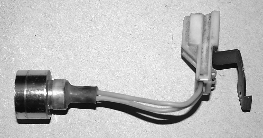

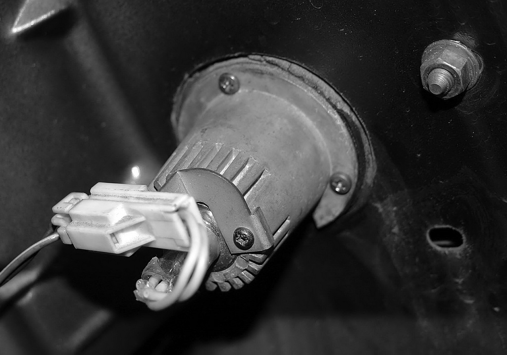

I am posting my version of fixing DELICA tail gate light in pictures as promised. All you need to know is that the light assembly is accessible from inside the tail gate and you also need to have some soldering skills. The pictures will tell you the rest. If you have any questions do not hesitate to ask me.
The replacement bulb and the sealant bought from Canadian Tire.

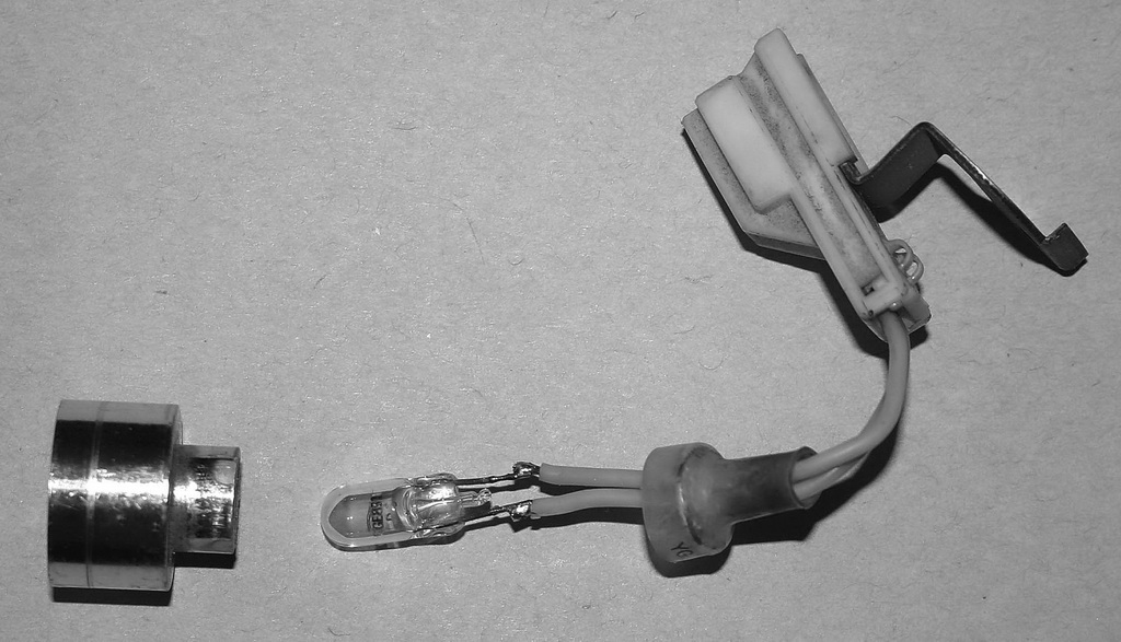

The original assembly taken apart.

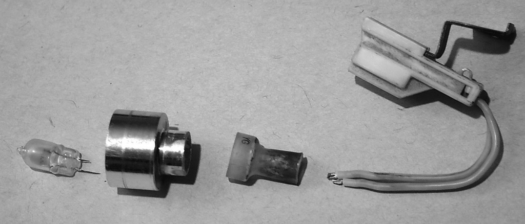

The replacement bulb soldered to the wires.
All the parts put together.
The assembly is mounted back to the tail gate.

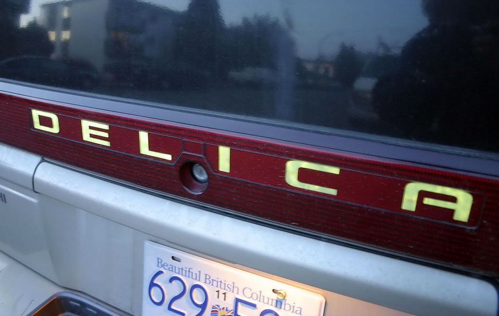

Now it is DELICA, not ICA!
