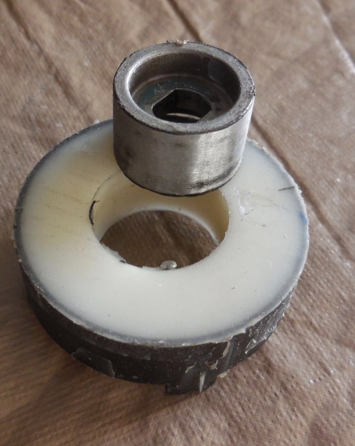

Since I bought my Delica, the passenger side window motor would spin, but the window would not go up or down without help. Clearly something was stripped. Last night, I got after the fix.
The door panel comes off with 3 or 4 screws, and to get the regulator out, I used this tutorial:
http://www.delicaclub.com/viewtopic.php?p=169885#169885
After that, the motor comes off from the regulator with 3 screws, and the cap can be pried off with a screwdriver, leaving you with this:
Some investigation showed that the rubber had separated from the smaller gear that actuates the window mechanism. The red line points to the separated area. It's not necessarily a bad design, but it definitely failed at the weakest point.
To fix, I ground a slot through the rubber and the small gear, and I cut a chamfer in the rubber around the small gear using an exacto knife:
To transfer the torque better, I put a piece of tubing into the slot (brake line tubing that I had in the garage, you could use a bolt, a nail, whatever you have kicking around).
Then JB-welded the whole thing:
My theory is that the JB weld only needs to hold the tube to the back of the gear. The tube itself should transfer the torque from the rubber to the gear. Any torque transfer that occurs via the JB weld in the chamfer is just bonus. Looking back on it, I probably should have just tack-welded the tube onto the back of the gear. That'll be plan B if this fails.

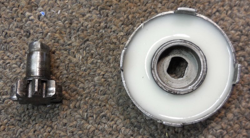

Returned from Vancouver last night with some casting urethane. Same brand as deskinthewoods used here: ReCasting Bushings with Polyurethane but a different product. I had no idea Crappy Tire carried the product.
Today I cut out the old rubber with various blades and surprisingly didn't cut myself; even once!
Using a Dremel and a belt sander I cleaned up the surfaces and wiped with acetone. I built a jig to hold the parts coaxially while the compound cures. Tonight I mix and pour, and tomorrow afternoon, we'll see...
john

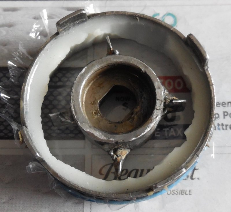

I couldn't get on this site to post an update for a while, but here's where I am now;
After the casting had cured, I put it all together and assembled the door.
At each stage I tested the window and it worked fine until I finished the door trim. Then it failed. Took it all apart again and found the urethane had cleanly separated from the inner hub.
After some thought, I welded 4 "wings" on to the inner hub to give it more surface area to stick to, and even if it doesn't stick, it will mechanically transfer the rotation (I hope). Recast the urethane, cured, reassembled the mechanics but left the door trim off until it's tested for a while.
Once I get my brakes fixed (stuck caliper again), I'll "spring clean" the van and test the window extensively before putting the door trim back on.
I will post in this thread again if the problem re arises, otherwise, it's still working or I no longer own the van...
