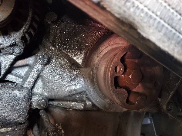

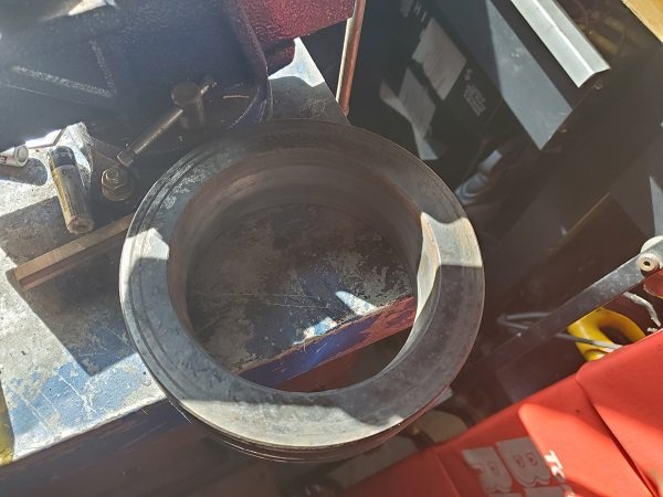

I am pretty mechanically inclined and am willing to attack painful jobs myself. I have tools, a garage and a spouse who'll let me borrow their car when mine is on stands for a few days. I've done the IP seal and most recently my crank pulley on my 2.8 which made me take apart the whole front just to get at it.
Also a heads up check your pulleys, mine had fully separated, luckily I caught it before anything blew up.

Here's some picks of my old 2 piece pulley
I was very surprised to find no other damage.
