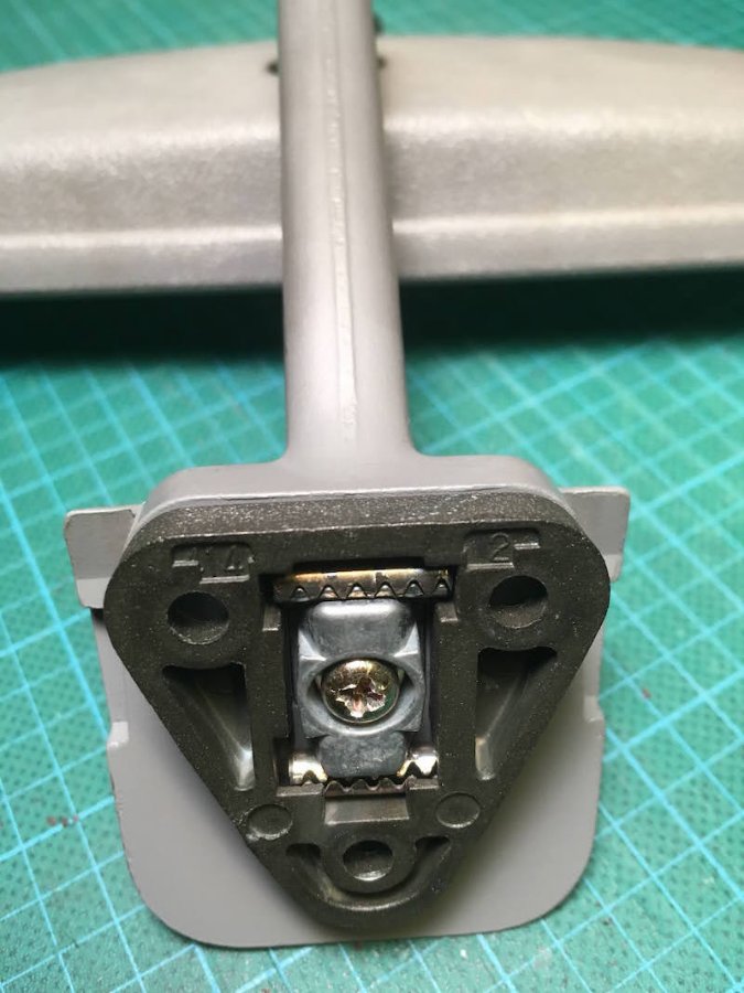

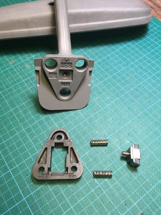

All of a sudden, my rearview mirror was all loose and jiggly — the one in the middle of the windshield, hanging formt he roof. I guessed after a decade of driving on logging roads, the screws that mount the mirror to the roof had loosened up. Went to tighten the screws, and all three were perfectly tight. So I took the mirror off, and the way it’s mounted, there are these two, tubular springs holding it in. I guess it’s mounted this way to damp vibration, so that the mirror is clear, while everything else in the van is vibrating.

I found a couple of metric bolts just slightly larger than the tubular springs, and tapped the bolts with a hammer through the springs, spreading them apart slightly. Then holding the bolt with vice grips, I heated the spring cherry red with a propane torch. Did the second spring the same.
I removed the charred bolts, reassembled the mirror mount, and it works like it did before. No jiggling anymore.
