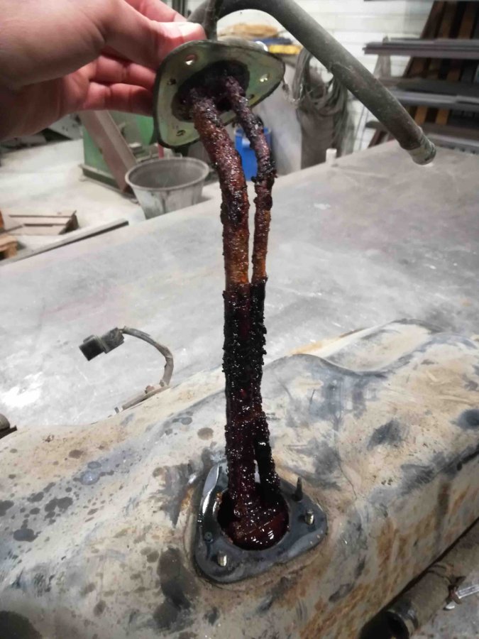

After that I had a bigger problem, the last owner let the van without driving for a while and all the tank was covert of diesel algae. All the diesel pipes, filters was stuck with this sticky paste.
So I took off both tanks and I directly plug a diesel can on the diesel filter. The engine was running again perfectly with this temporary solution.
