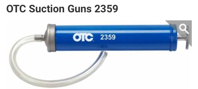

As to where to get oil, I go to Benson’s Autoparts. Should be one in your neighbourhood. It’s a good idea to invest in an oil change hand pump, Benson’s has them for ~$35. It’s really hard to get oil into a diff without one
