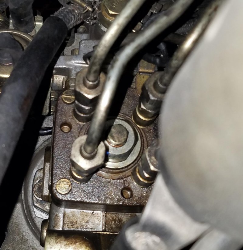

My injection pump is leaking through a bolt on the back that connects the pump head. From what I have gathered there is an O ring for the pump head that needs replacing. Is it possible to replace the o ring with out removing the whole pump? Is there anything else I should do while I've got it apart?

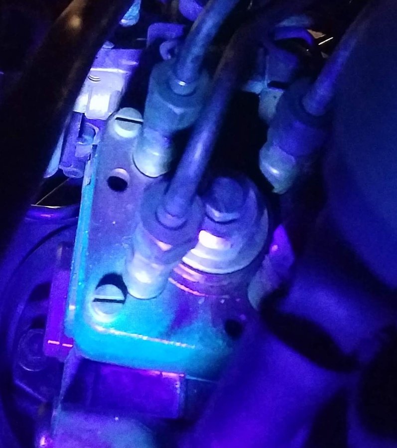

One image is regular lighting, the other is with a black light showing the fuel in turquoise. I had to use some tracerline just to find where it was coming from since it blows everywhere when driving. Definitely looks like it's coming from the bottom left bolt.

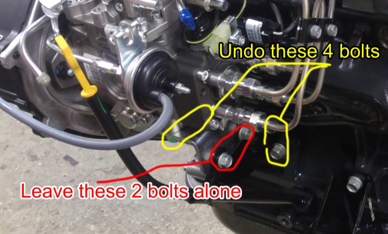

Under the injection pump there's a 2-piece steel bracket that bolts to the engine block. The bracket has slotted bolt holes that you loosen when you're adjusting the timing. If you leave the slotted hole bolts alone, and instead remove the bracket-to-block bolts, you can remove the IP without disturbing the timing. Or, at least, reinstall the IP in exactly the same orientation it was.

So... Theoretically I'll be able to take it off, replace the seals, and reinstall it with out having to redo the timing? That seems too good to be true.
