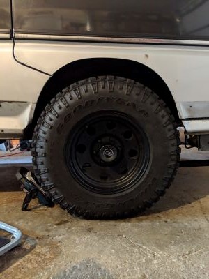

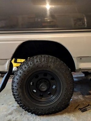

I installed the 2" lift kit that Jesse offers, new shocks, and new torsion bars. The install went peachy keen until I took "Truck Norris" off the jack stands.
The front end was lower. How could this be. I crawled back under and cranked the torsion bars all the way up and it was still too low. I re-indexed the torsion bars and still too low.

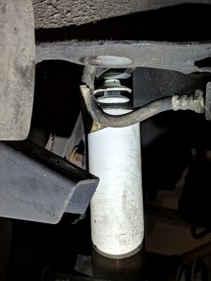

I noticed the front shocks were completely collapsed.
The front shocks (Pro Comp ES9000 915510) are recommended on his lift kit post http://www.delica.ca/forum/viewtopic.ph ... 95#p138695.
Is it the shocks?
Did I screw something up?

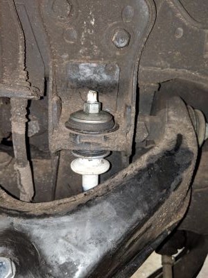

I forgot to include this picture. Notice the upper bushing. I had to use 2 vice grips plus my own kung fu grip to get that nut on.

2" lift woes. What did I screw up?
javabob wrote: Are "upper rebound buffers" Mini speak for bump stops on the Deli? If so I removed them. Should I put them back on?
LOL! It's totally Mini-speak, now that I think about it. They're the top bump stops, but they control droop not bump. You usually need them in place- they prevent the suspension dropping so far it rips the shock absorber out, not to mention the damage that could be done to the top arm from hitting their metal mounting bracket directly.
Measure the stroke length of the shocks. They should be 15.5" long. Also the part # will be stamped on the side of the shock body. It is possible you have the wrong shock (too short) in which case the travel is maxed out to whatever the length is.
If it's the correct length, then it's an indexing torsion bar correction that's required.
jessef wrote:Measure the stroke length of the shocks. They should be 15.5" long. Also the part # will be stamped on the side of the shock body. It is possible you have the wrong shock (too short) in which case the travel is maxed out to whatever the length is.
Good point! I totally ignored the bit about the new shocks. I would undo the two lower shock mounting bolts so the shock is completely out of the equation. (Actually I'd undo the top nut, but since yours was a pain to install the lower bolts are probably easier). If your ride height returns to normal, it was the shocks being too short and restricting your suspension travel.

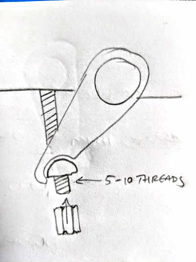

javabob wrote:If I take it off, turn the torsion bar, and put the adjuster back on, it shouldn't make a difference right? What am I missing?
You're not turning the whole torsion bar. You want to leave the torsion bar in place and attached to the top arm, just slide the adjuster off the torsion bar's rear splines, rotate the adjuster down a bit, and slide it back onto the torsion bar. When you push up on the adjuster to remove any slack in the system the threaded rod should *just* poke out the end of the halfmoon pivot nut thingy, just enough threads exposed so you can start the adjustment nut.
