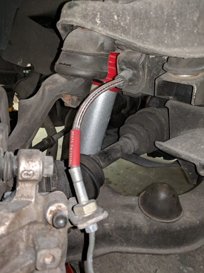

The trickiest part is routing/orienting the brake hoses so they don't kink or pull with the wheel at full lock. I had to modify the bracket and steel brake line at the caliper to get the short lower flex hose pointing in the right direction.
When I eventually replaced the brake hoses with stainless braided, I used a single-piece hose 400mm long (about 15"), routed it loosely through the middle bracket (with a piece of rubber tube to prevent rubbing) so it can move a little as the suspension and steering move.
