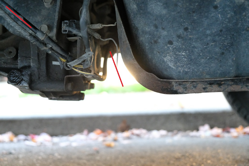

My speedometer has stopped working (reads 0 km/h no matter how fast I'm travelling) after pressing the tripometer whilst driving. Both the speedo and tripometer failed instantly after resetting to zero (tripometer is off kilter zero).
-My odometer has been stuck at 129,999 for as long as I've had the van (~3 years).
-RPM & Speedometer have intermittently read zero before, but never long-term and never in the middle of driving while warm. It seemed to be a cold-start / humidity related error.

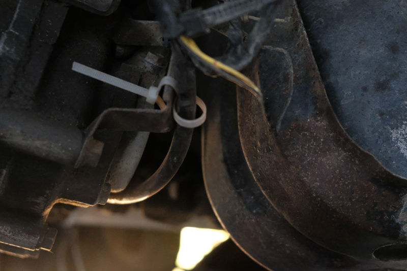

So I'm looking for the speedo cable entering the trans..fer...case..mission? I recall this cable I noticed damaged some time ago (forgot to figure out what cable it is) while inspecting the rear u-joint where the driveshaft enters the differential(?). I think this *may* be the speedo cable? I looked through the manuals, but since the cable goes through so many parts of the van ... category is a bit elusive ...
It had been rubbing on some rusted tie-wire holding various electricks in-place. It's hard to see in the photo, but I filed the rusted wire and replaced it with white zap-ties where there is a sizeable gouge from the wire.
Wondering if someone could help ID this wire?
Speedometer, odometer & tripometer offline, any suggestions?
Yup, that's your speedo cable. It's not an electrical cable though, it's a length of tightly-coiled steel wire that spins as the driveshaft spins.
For a quick diagnosis I would remove the instrument cluster, and then roll the van backwards while watching the end of the cable in the dashboard- if it turns then all is well, and the fault lies in the instrument cluster. If the cable doesn't turn there's a break in the cable.

The strange part about the cable is it feels solid rather than having anything inside, nothing visible inside the gouge. but i understand the concept of cable inside cable housing.
Sounds like a good test. To be clear - roll van in Neutral. Or engine running; drive/reverse?
Thanks!
Either way. As long as the driveshaft is turning, the inner speedo cable should be turning.
The best part of the test is that if the cable doesn't turn, you extract it from the outer cable from inside the van. Just grab the squared-off end that goes into the speedo and pull. Have rags handy though, it's usually disgusting with 25 years of grease and metal dust.
sealica wrote:it feels solid rather than having anything inside
It's a spring tube- tightly coiled spring steel, covered in plastic. You're not going to be able to squish it to feel the cable inside.
