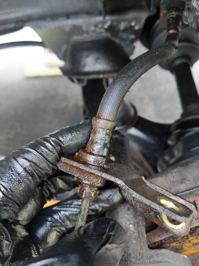

OK, so I think I got the wrong part. I went to the local shop and we found a match on a 1990 North American Mitsu Van but it looks like I got the MR129744 instead of the MR129771. I'm finally under the wheel here and now... how do I get the dang hose disconnected from the bracket?
- 2018-09-27 10.50.06.jpg (613.01 KiB) Viewed 10126 times
- 2018-09-27 10.50.02.jpg (618.46 KiB) Viewed 10126 times

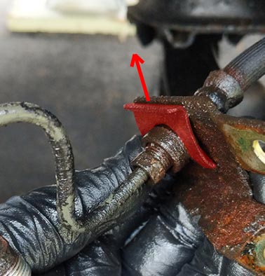

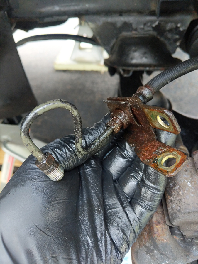

That clip comes off. Honestly. They're a complete pain when they're rusty like that, but they *do* come off. I usually use a screwdriver to lever between the clip's lip and the brake pipe union.

Got it! Thanks!
