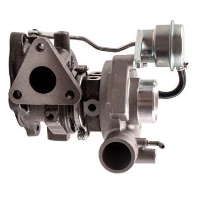

I'm guessing it was a 4D56 TD04 from a Pajero or L200. They have the wastegate actuator down low, mounted to a bracket on the turbo itself, with the actuator rod horizontal. Which means the little wastegate lever on the turbo is oriented the wrong way and has to be modified (bent) to work with our vertically-oriented actuator rod. Here's one when viewed from above:
Not sure how we know it was making 10psi without a boost gauge though. I'm guessing the mechanic tested it before replacing it.
