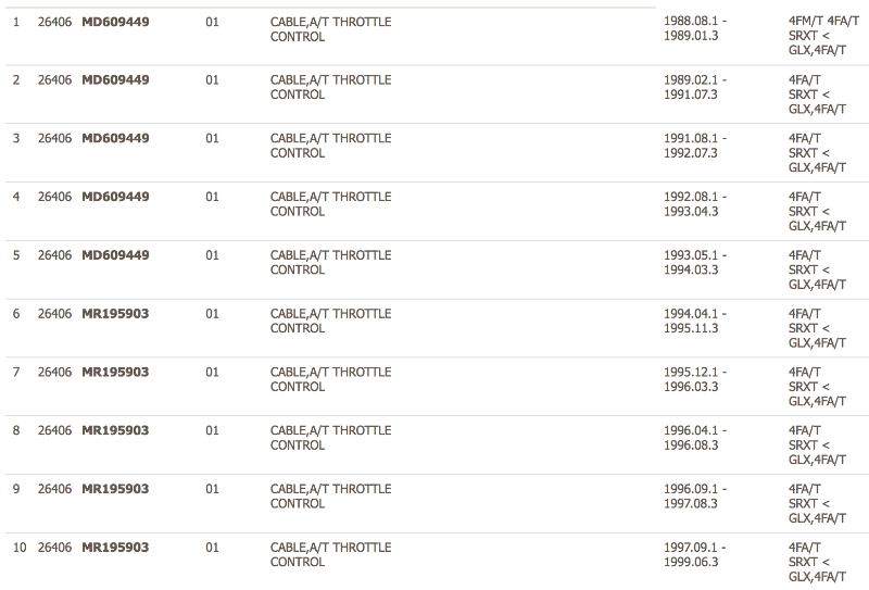

Screen Shot 2018-08-02 at 12.40.42 PM.png (131.78 KiB) Viewed 8017 times

Those part numbers are for a diesel engined Delica. Andrew has a 4G64 petrol engine. MB919151 is more likely the correct cable for his van.

Oops, sorry!! :shock:
Mine is a diesel and not the part you're looking for:)
