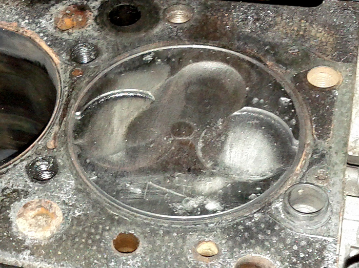

Slightly damaged pistons from a failed glow plug are common- as long as the edge of the piston (where it meets the cylinder wall) isn't chipped, the cylinder isn't scored, and its compression figures are about the same as the other pistons, it's ok.
Do you have any photos of the damaged piston? Here's the damaged piston from my old engine- note the dings and dents. It had no issues at all.
